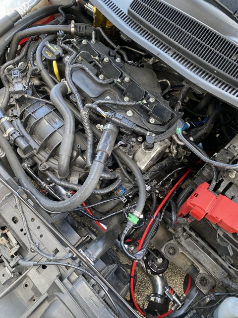

I run a stage 2.5 with a solenoid and then nozzle goes in the intercooler pipe. I plan to add 4 port and a Phul lpfp for my fuel before I do Nostrim high pressure stuff.
