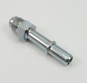

Nope hard line against the fire wall into a flex line that has the quick disconnect, its one piece though. That attaches onto the hard fuel line off the engine.
I did take this one pic. You can see the flex line in it...

#26
The flex line is what you remove and replace with the hardware listed herein

On the 2015 the flex line is actually part of the hardline. There is no connection to undo.

You'll need to cut the flawed line and bead the hard line then.

I got one of those and a double female 6an swivel. But since I am doing six fuel I think there is another way.
What part number did you use for the parts? I think I can get away with just that part alone
I have worked on prob 20 2015's and that's the first I seen like that. That is crazy and good to know. I have found serval odd things through the car like this. Random part number changes.

Radium PTFE -6AN Hose Assemblies - 11.4" Straight and 90* ends
I'm putting together my ECA-2 install and I can't find this part and Radium's site is down. :(
Anyone know where I can buy this part or a replacement
