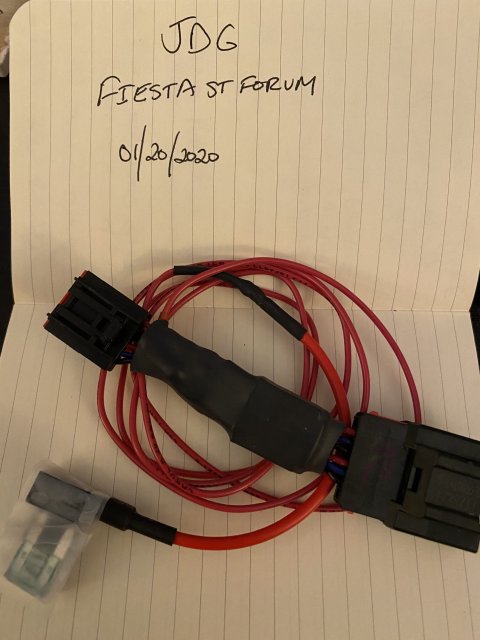

Traction Control Auto-Off Module
https://www.fiestastforum.com/threads/plug-and-play-traction-control-off-module.18531/
View: https://www.youtube.com/watch?v=ZKWcrsMD24I&feature=emb_title

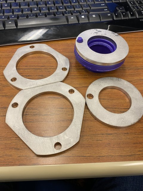

Front & Rear 1/4" Spacer Lift (Stainless Steel, 5/8" Overall Lift F/R)

14,942
7,381
Did they yield a 5/8" lift over just using the B6es and factory springs, or over the full factory suspension setup?
BTW; The white Pro Rallies DO look good on the white car when they are clean, sort of like a WRC test car, or even a recce car. [thumb] [cool]
JDG
JDG
1,863
1,995
Conshohocken, PA
Thread Starter #17
5/8" compared to a completely stock vehicle. But I can really do any lift between 0-3/4" with different height spacers.
