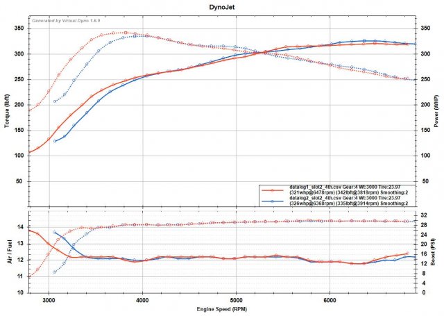

Things are starting to kick again with the new, stiffer wastegate actuator. AEM 3.5 BAR MAP Sensor is due in Saturday so we can increase the boost past 28PSIG. Ambient temperatures in the low 80's here:

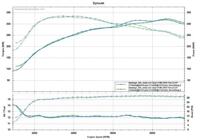

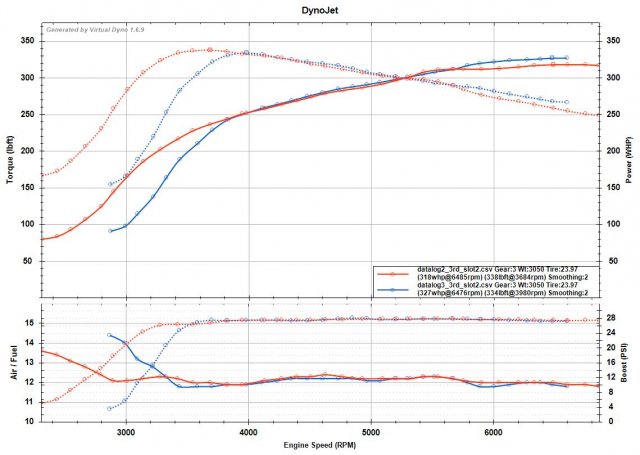

New AEM 3.5 Bar MAP sensor installed. Ready for more boost!
Walked a couple of bolt on Subaru’s tonight during my datalogging session (2016 wrx fbo pump gas, 2007 sti fbo pump gas)
Felt good.

Nice horsepower curve. I'm a little surprise to see you start to lean out with the 4-port.
Not running out of fuel, still tuning. My aux fuel injectors will flow enough for 600whp lol.
