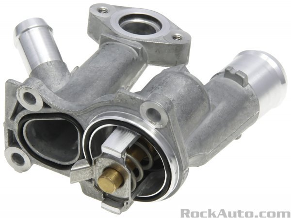

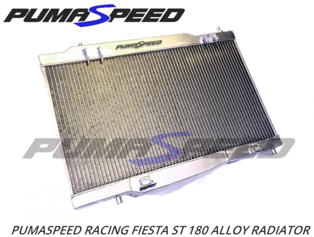

This is true, absolutely! I DO run a huge oil filter that does help surprisingly well as a 2nd mini oil cooler, but to just drive 15 minutes in stop and go, then exit to a small hilly area and nearly overheat is just not acceptable for any car, period. I wasn't driving the car hard at all, I just hate how I have to feel frustrated in traffic to try to keep moving just to keep air flow up to avoid overheating. They could at least offer the newer 180 degree thermostat installed for free for those of us not part of the actual recall to help get that coolant flowing sooner, but that too can lead to running cooler than ideal most of the time for keeping the engine clean as well. The real solution would have been to simply have used the same 2 row ST180 radiator most of the world got, but instead we get the crappy 1-row, crappy reflector headlights with no option for better, but yep of course there is a $2000 high profit Recaro package as an option... Not saying that the Recaro option is bad, at all, just saying they pinched pennies in an insulting way toward the North American market, it's just sad...
