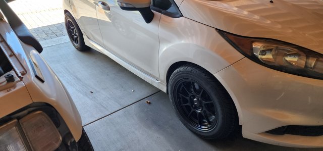

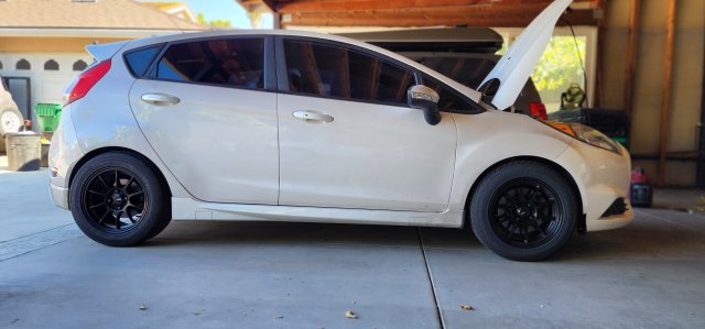

Thread Starter #11
Quick dirty update picture. Hopefully some helpful information.
15x8 +35 Dekagrams
225/50r15 ECSTA AST
Stock springs
Installed koni yellows up front.
Rear koni yellos and poly spring mounts on the way...
7.6 pounds lighter than stock
total of 30.4 lbs of rotational weight removed off the car.
No rubbing while turning or driveways.
Only rubbed lightly when bottoming out the suspension on a bad bump on the freeway.

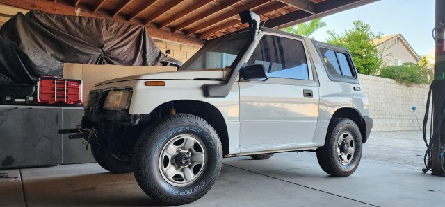

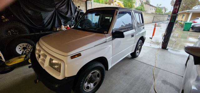

Good eye! 96 Geo 2 door Tacker manual 5 4x4,
Smaller and lighter than the Fist 😆
got it a few months ago bone stock,
Stock....
Upgrades in progress working on the winch.
