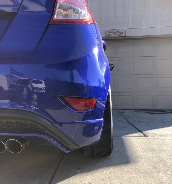

Good discussion, 15” and some taller sidewall compared to the 16’s, tires will flex and load towards the struts under heavy cornering. With 16x8 ET35 on a 225 tire like the R888R it’s a little close to my liking about 1/2” or less so that’s on the 16” Dekagrams with coilovers. ET 40 would need 7.5” wide wheels in 15” for me with 225’s but may be even better with 215’s... there’s plenty of 7.5 wheels too and they are typically 2lbs lighter. Trying to optimize. Would be nice to have a bunch of stuff to test!
Current 16x8 225/45R16 setup is about an inch lower than stock, and slight rolling of the rear fenders but not really necessary with good spring rate. Trimmed the outside edge of the rear liner though as that would rub. Forgot to mention -2.8 degrees camber 😂 picture shows a bit lower, perhaps 1/8 lower, than current configuration.

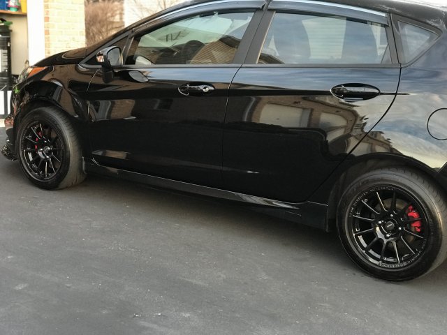

I wanted Gold but these will be fine lol
You could always paint them once you have to replace tires.
I am not all that fond of the TD/Rimstock very light gold color, and like the slightly darker/deeper shade that Speedline uses anyway.
