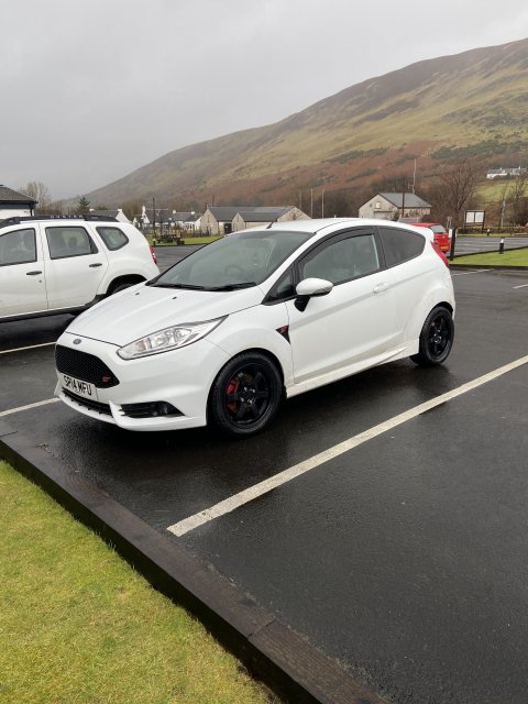

Thread Starter #12
1form JDX’s really liked the look of them, nearly went for Rota slipstreams but preferred look of these and I will do!

Thread Starter #16
Poor photo quality but the JDX’s fitted great and the ride quality is a lot better plus I love the look of them!
