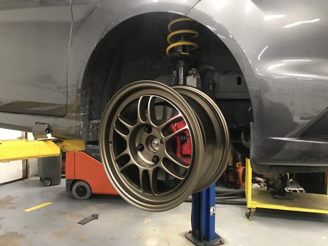

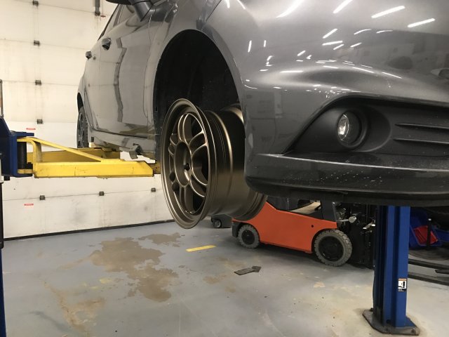

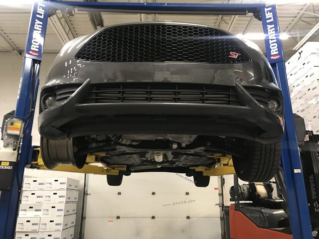

(plz excuse our dirty car)
Here they are!
Tested front and rear and looking great. No concerns with clearance anywhere.
These are now in stock and ready to ship! Shoot me a PM or email about ordering with forum pricing.
Pre-orders have been shipped as well.

I dunno man, test fit to me is tires on, and weight on wheels. 🤷🏻‍♂️

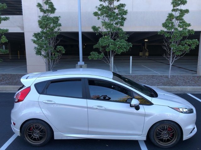

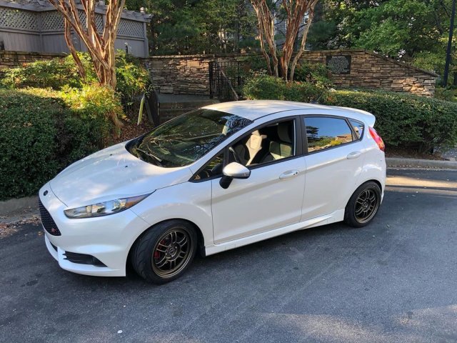

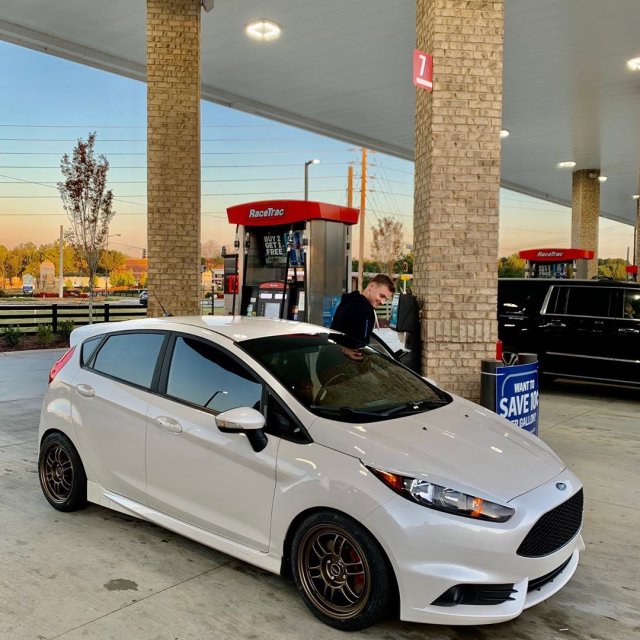

Noice!!! What’s the suspension setup on it, tires? Any rub?
I believe he is on Meister R coilovers.
No mention of any kind of rubbing.
He said he wants to go lower than it is now, which is a good sign.

Can we get some pictures of front caliper clearance for BBK users?
The best I have right now are the pics posted above of the dry fit.
What kit are you trying to fit? I will gladly take some measurements.

Any id
Any idea what size tires he's using? (I cannot read the sizes even with the pics blown up. [:(])
