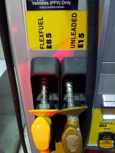

There is an E85 dispensing Wawa station in northern Lansdale (JDG on here has been there) on 200 Forty Foot Road (RT. 63), which you are even that much closer to than I am here, way out near New Hope. [thumb]
I want to install the radiator, new OEM hoses, and the intercooler all at the same time (as well as hook up the ST200 box's inlet duct hose to some opening in the bumper), so that I am not pulling off and re-installing the bumper cover once a month, like so many on here do, but I cannot due to HOA circumstances/rules. [:(]
(So it may still be a while until I get to this chore.)
Girlfriend just told me she knows exactly where it is.
