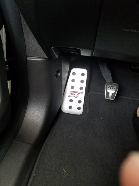

Some bling for interior. The dead pedal arrived today. Put some red plastic behind the ST. It's not as good as a solid dead pedal section but protects the carpet and looks nice.
