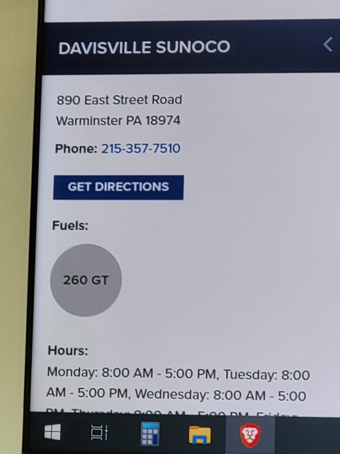

Found a Sunoco station with 260GT at the pump. Currently tuned for 93. Wondering if this would give me any benefits WITHOUT tuning on it.
https://www.sunocoracefuels.com/fuels/fuel/260-gt
An anecdote for you - once my tuner finished the 93 tune, we switch to e30 and immediately dynoed again, no other changes to the map. Picked up ~20 or so whp just from fuel. I suspect this fuel would perform well but whether or not you can notice, hard to say.

Is it the one in Horsham, on 132 (southbound side) across from what used to be the only other E85 (and E98 racing as well) station in the area (Omega Fuel), now long gone?
$10.00/gallon?

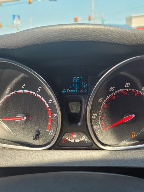

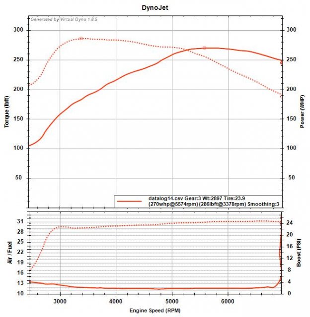

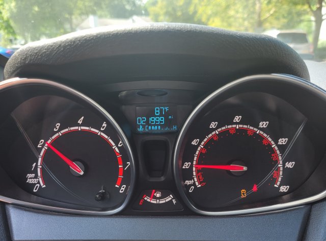

Rolled 22k miles today and just as the fuel mileage was continuing to improve...E30 tune came in. Only have 10 miles since swapping fuel BUT now I can swap between E30 and 93 and even low boost on the fly. Couple more sets of logs then I can compare my 93 vdyno with the E30.
edit* just realized this makes 500 miles on the whoosh hybrid. That was a quick 500 for me. DIgging this thing

Ordered some whoosh boost hoses and a vented filter for the top of the Damond OCC.
Really contemplating some 30% injectors to open up the E30 a bit more.
Feel like E30 on the stock turbo was a bigger jump over 93 than on the Hybrid.
On the stock turbo, tuner stated clearly turbo is maxed out but with the hybrid clearly stated I was out of fuel.

Unfortunately I didn't check the crankcase psi prior to installing the OCC vent but with it on at full WOT never moved over .02 psi. I also coincidentally hit highest boost PSI ive seen on the hybrid while running E30 during that pull 25.5. Typically on E30 I see between 23.8 and 24.4 and due to being out of fuel at the top end.

Does AFR typically change when on E30? On 93 I see high 13's to mid 14's.
On E30 I see high 12's to mid 13's. Not sweating it, mostly curious.
