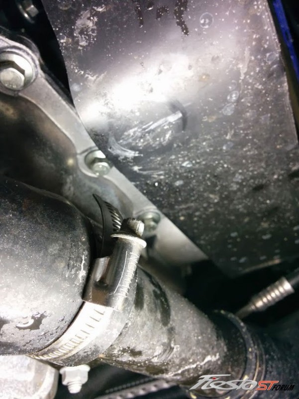

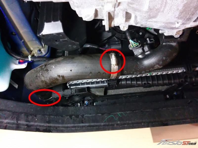

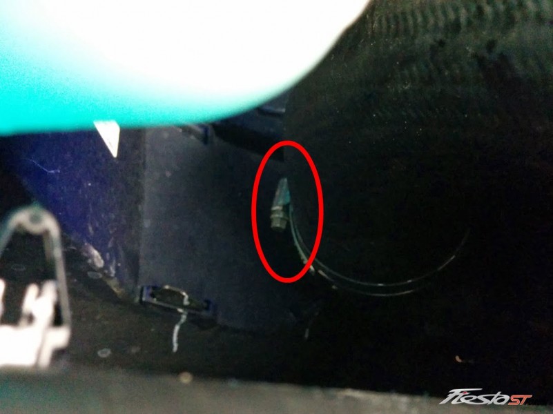

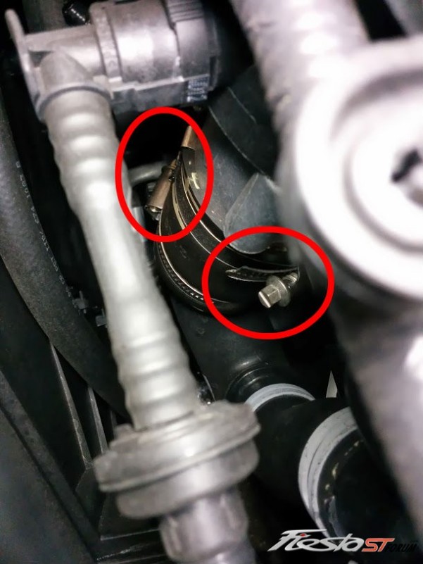

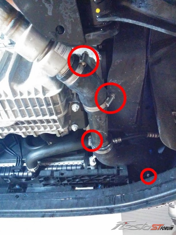

I'll get under the car with some wrenches this afternoon and see if that helps at all. I'll also take some logging of the timing advance if possible. Thanks everyone.

So i got under the car yesterday and was able to tighten each clamp quite a bit. Initially it did not seem to make a difference, but today it feels like it is spooling more quickly and at a lower rpm. It may be the placebo effect, but it does seem faster. So much in fact that I got lazered when having a bit of fun. The officer let me go with no speeding ticket, but written up for impeding traffic so no points. Maybe this car was a bad idea for me. [facepalm]
