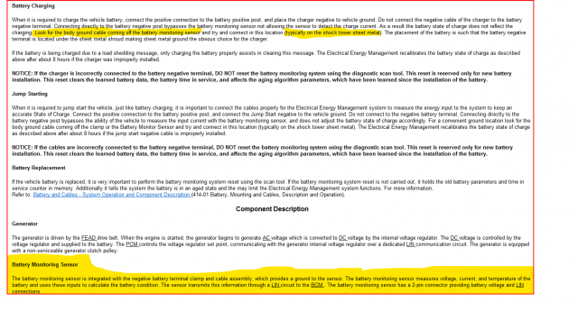

Without reviewing the other threads, my guess is a weak connection to ground. EDIT Memory serving I think there's also a secondary connection at the positive terminal. /EDIT If the battery tray was fiddled with, the ECU is attached to it. This I've seen, is not uncommon among manufacturers.
(Side Note: Ford unwisely stuck another ground right frick'n beneath the battery tray - the acids will rust this out. Probably an engine/trans/alternator ground. )

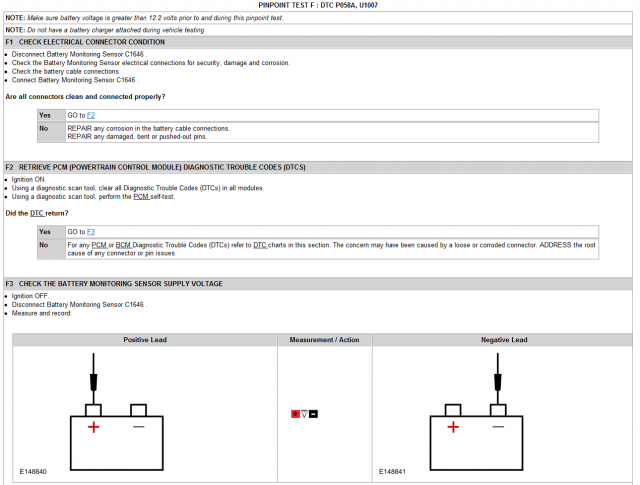

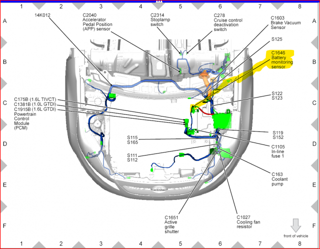

S i have checked all fuses and grounds and wires and cables..and still getting u1007 could it be the neg.BMS be bad... is there away to bypass it at all

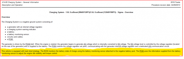

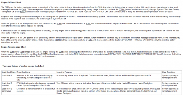

@Sam4 - The fault began on the way home, by which time the battery was killed. When he replaced it, it cranked but wouldn't start. When the battery monitoring system (BMS) is detecting a fault code, the Body Control Module and Powertain Control Modules won't allow the system to charge the battery; or allow the car to restart after shutdown. So it cranks, but won't start.

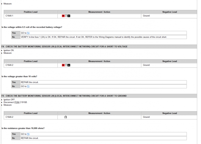

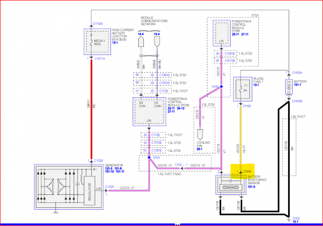

@Intuit- I'm gonna take some pictures and upload them so you can see. When I got going on here because I have the two prong wires coming off the neg.bms to a 3 amp fuse yellow wire stops there and the I got another wire a purple the runs directly form the bms neg side to the pcm that's it
