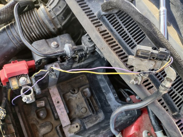

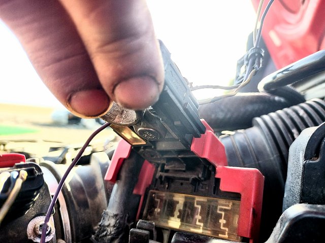

Has anyone ever tried bypassing the battery current sensor or the battery monitoring system..

Can't see your attachments; forum says they don't exist.
I did notice the fuse in the diagram.
Was that fuse intact?

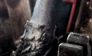

Wires look suspect but I guess that's just from you unbundling to inspect for damage?
What's the deal with this little patch here?
D
Dpaul918
U.S. Marine Veteran
24
Mendota, CA, USA
Thread Starter #30
I never noticed that I just bought the car of a guy selling it for his son.
