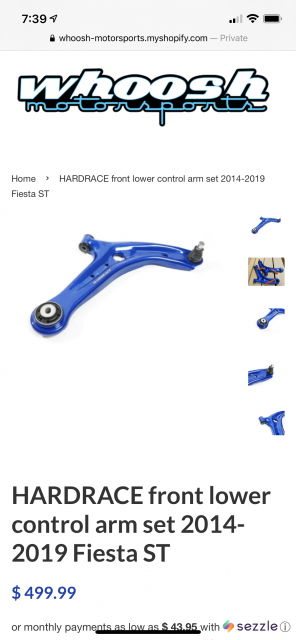

So it was time to go ahead and get my front end worked on. I replaced the Sway Bar links, and Toe Rod Ends. And I was replacing my control arms with bushings at the same time. Well when I took old one off and went to put the new one on from Napa and it wouldn’t fit everything was pretty much the same but bushings were a lot smaller than the old one. Turns out that they sent me a Fiesta control arm. Every auto shop said they don’t have part #s for it and that all have to get it from my dealer. I started looking at these 2 control arms on Whoosh Motorsports and I was wondering if anyone has had any luck using these! Ones from DNA Racing and the other is a HardRace front control arm.

I know of one local FiST owner near me who is using the HardRace control arms mostly because they hold up against the crap Massachusetts roads versus the DNAracing arms which are more designed for track use and not so much daily driver on crap road abuse( they have potential to bend on a bad pot hole strike from what I was told).

I just installed my hard race control arms in mine a couple days ago. Haven’t gotten to drive the car yet because of shitty PA weather :( but the fitment on them was good I can say that if I have any issues with them I will be sure to come back and let everyone know .

The only reasoning that I could see that one would think that they are weaker would be that there’s no bracing in rhe corner of the control arm but they are meant for track days no? So you would think that they would be able to handle alott of load ?

They're more designed for track use and smooth pavement. If your car is only going to be used for track use I'd choose them over the Hardrace for the lighter weight. The DNA can have a tendency to bend after a hard pot hole strike while the Hardrace are a perfect daily driver/spirited driver with track use.

I'm not sure if I buy that or not, have you known anyone to bend them?

One other person. They weren't for a FiST though but on a Fost. It's one of those things were not all parts designed specifically for track use equate to good for regular potholed road use.
