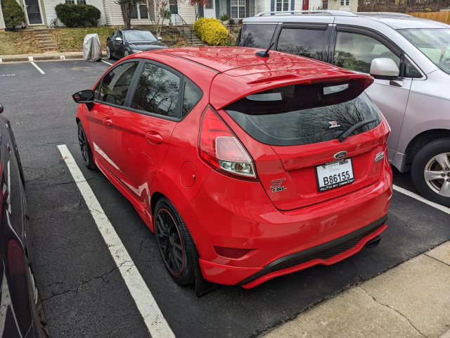

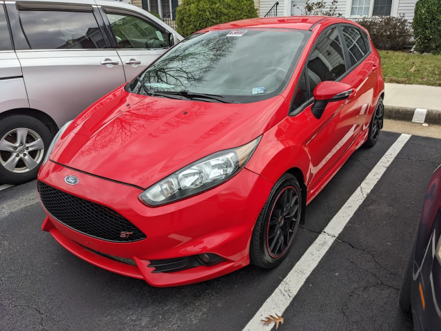

Just got my Fiesta ST and already have a few ideas on how I plan on starting my build. Probably the first thing I'll be doing is to upgrade the factory Sync 2 radio with either a nice Android headunit or do a Sync 3 plug and play headunit. The car already has a bunch of stuff done to it and some of it I want to switch out. I'm thinking of doing an MBRP exhaust and a Miltek down pipe. 1669667388665.png 1669667401824.png

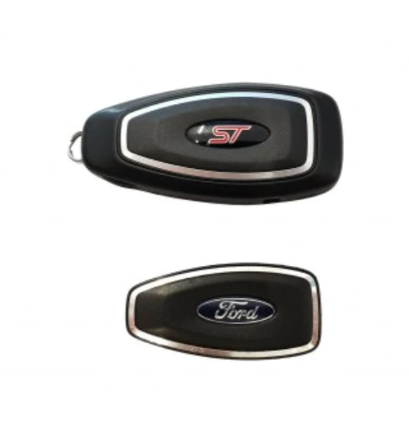

Just ordered the 1st of many items in my build. My key has a broken tab on the cover so I ordered some OEM key covers with the ST logo from Whoosh. my car did not come with a 2nd key so I will be ordering a 2nd key and attempting to program it with Forscan.

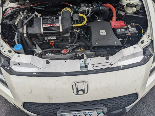

Not really Fiesta related but for everyones viewing pleasure/eye candy..... This was my setup on the CRZ. Takeda intake, maxbore throttle body and a Sprintex supercharger with a 77mm pulley. The thing I will always miss about the CRZ was the incredibly loud whine from the supercharger. The instant torque was also a warm welcome. the electric hybrid system made 22 HP and 50ft/lbs torque alone. Exhaust was HKS high flow cat and HPD exhaust. Nice and throaty but didnt drown out the SC whine.
