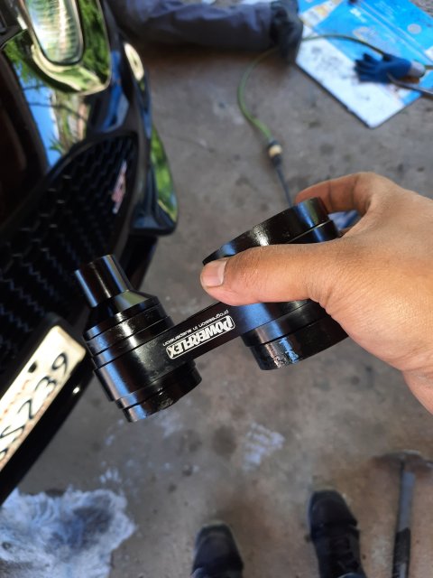

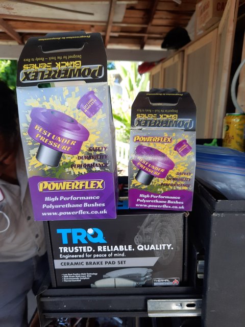

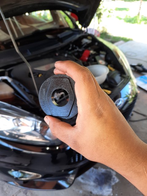

Yea, I'm starting with the bushings first. I've already got the powerflex engine mount bushings for both of them. They make the biggest changes in ride quality in my opinion especially when It's got some miles on the car. My ST only has 20k while my SE has 80K on them. Currently, the ST has very little engine shake when I shift or accelerate but the SE feels kinda laggy when it comes to putting its power to the road. I remember when I first go it had a spring in its step.

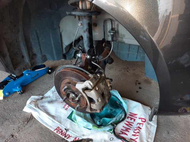

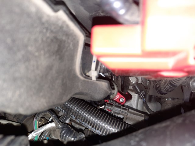

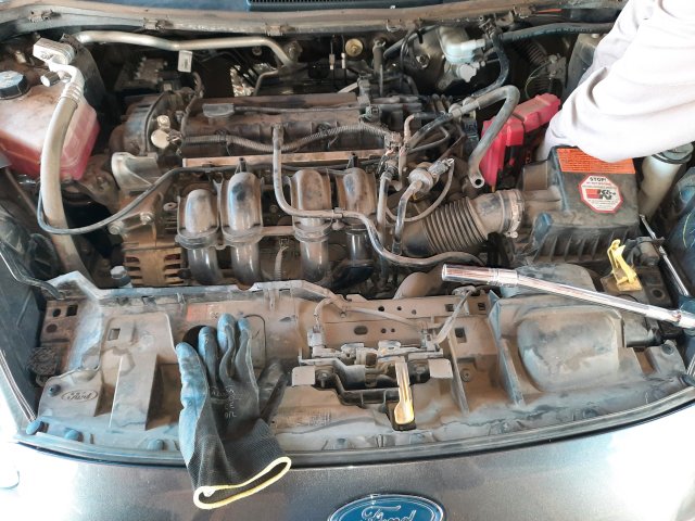

Just finished putting in the PowerFlex mounts in both SE and ST. I also changed out the rubber brake lines on the SE for steel and changed the brake pads for a low dust ceramic pad. The install of the Whoosh Short Shifter was surprisingly easy. I took out the battery and then realized I really only needed to remove the airbox, lol. NVH has increased on both cars but it really isn't all that noticeable unless at low speeds. once you get up to speed it really doesn't overpower the sound system. Which is good enough for me. I still need to add in a RMM for the SE tho.
