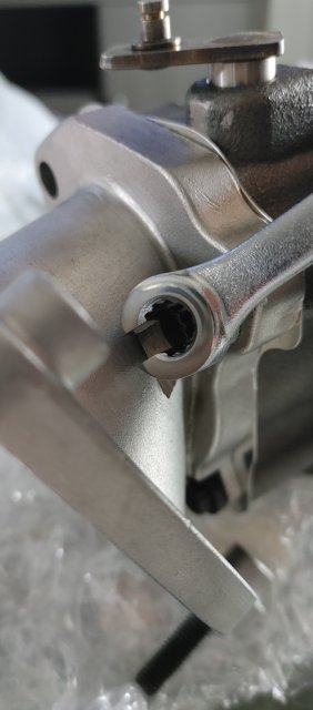

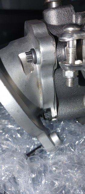

So I'm pretty sure it's impossible to take two of the five flange bolts out 20210414_174048.jpg 20210414_173657.jpg

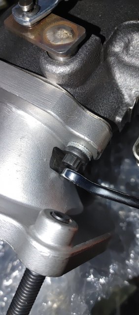

Well that didn't work. Giving up on those two bolts. Hope I won't need to take the turbo out if they do come loose. 20210416_164312_HDR.jpg

Grind the tool down to fit. You could probably grind down a regular box end wrench if you really want to tighten those down.
Or an offset box end wrench.

I know I have posted this somewhere but a couple of notes for the GTX2860 install (specifically the downpipe adapter).
You will have to shave down a wrench to tighten those bolts as others have said. I put the end of another box end wrench on the smaller wrench to get more leverage and tighten them down real good (they love to come loose).

The tension from the Lockwasher should not allow these to come loose. But if your set on tightening them....custom design that tool.
