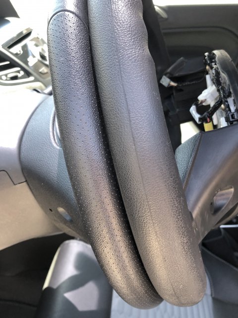

Some interesting lessons here that may really be helpful to someone by the way, spoiler is the first picture.

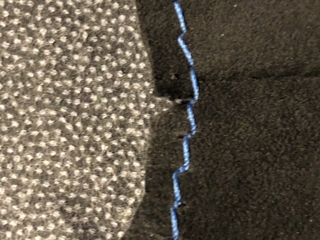

1. started out with purchasing a Redline kit to recover with synthetic Alcantara. Wanted a slightly thicker steering wheel as the stock ST is a skinny one. Applied foam and stitching project didn’t end up well as I easily ripped through the material so the cover was (somewhat) ruined.
2. Contacted Redline (Poland) they were slow responding back and forth but agreed to give me a little bit of a discount on a leather (stronger material) cover and more money to have them send me the kit, and subsequently install. I paid, received, and sent off the steering wheel.

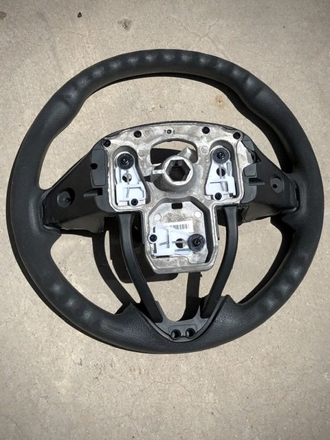

3. Ordered a cheap non-leather 2019 Fiesta SE wheel from e-Bay, it was like new. Thought about using the Alcantara cover that was torn, with a BMW stitching strategy that loops through the straight line stitches rather than through the holes in the material.
4. Steering wheel is much larger, so cover does not fit well especially on the sides. Started sanding down the sides... but then looked a the difference (nice to have another ST with a like new steering wheel to show.

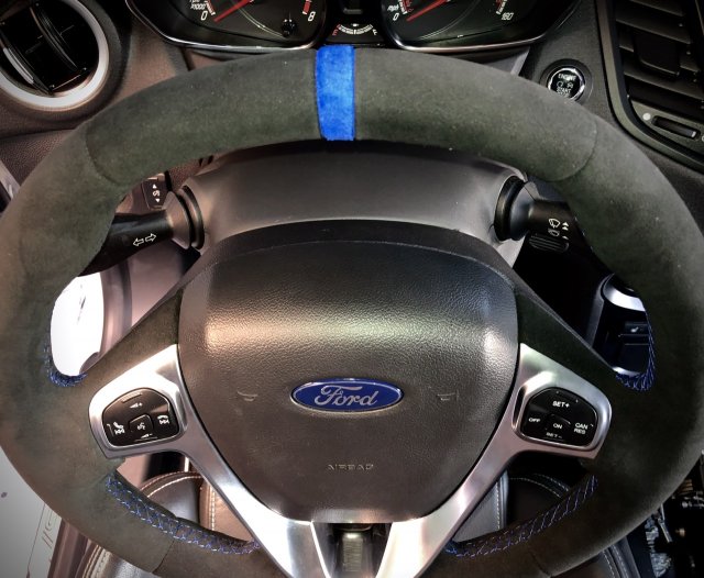

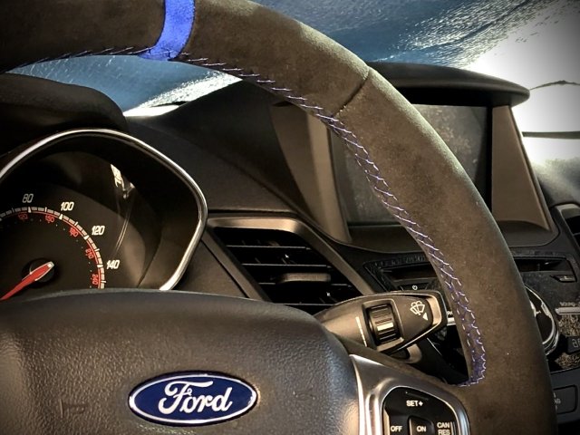

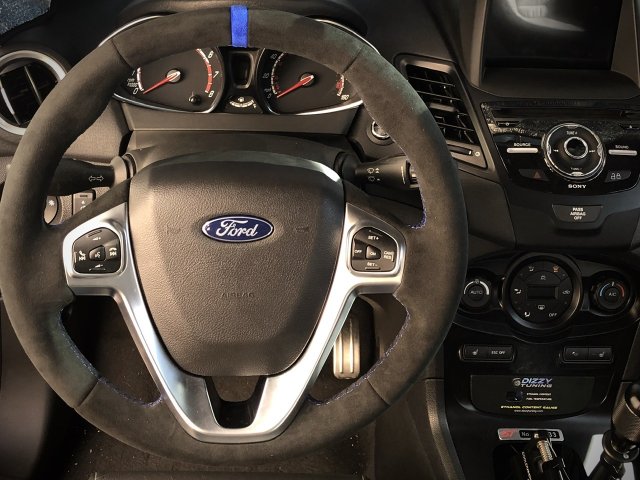

Turned out great... 2019 Fiesta SE wheel + sandpaper + Genuine Italian Alcantara + professional + $500 cash
Adrian in Phoenix -- "Steering Wheel Art" (480)939-1208
https://www.facebook.com/SteeringWheelsArt/
Super happy. This requires a lot of skill, and a little bit of glue... the blue ring is buffalo suede... feels great, original ST wheel feels cheap in comparison. My advice, do this right off the bat. I paid a lot more in failed attempts, and would have settled for a lot less... but the quality of material, the worksmanship, the end result, and for the price, it's the only way to go.

If you must retain the air bag, THIS is the way to go (and what I will do if I do not just say 'eff it', and get a Sparco suede wheel, and some QD hub). [wink]
That looks, and I'm sure feels, about as great as the factory form wheel ever could. [twothumb]

Wait, is the ST wheel smaller or larger?
Smaller!

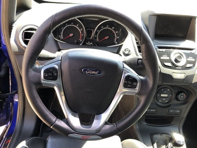

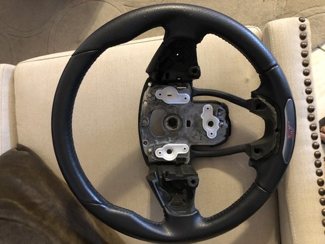

First post first picture shows the comparison... the ST wheel (installed on the left) is perforated leather and relatively skinny, feels like soft crunchy foam underneath tthe leather. Took the Fiesta SE wheel and put it right on top so you can see how much thicker it is. The ST wheel was in very nice shape, from the 2018 car... the 2014 was not very pleasant and some of the foam was collapsed under the leather. I sent this one in to recover. Now you see how many times I've tried to get what I like here, and what i have found.
Also, see the Alcantara extending on top of the switches in the last picture... this is possible with the SE wheel, the ST wheel has a big step here, so it wouldn't come out as nice. The SE wheel has some sharper style angles, so I sanded these down for a smoother look. If you remove the leather/foam from the ST wheel, it's narrow with deep grooves for the seams, not nearly as nice to recover as the SE wheel in my opinion.
I did send another wheel to Redline for them to recover, that's an ST wheel, I'l post a picture when it returns. It will be leather as they didn't like the simulated Alcantara I ordered previously too much and recommended leather with new foam.

The oval cross section (as opposed to round) is where most of the thickness comes from. Interesting how they have a more sporting shape wheel (in my opinion) for the SE, never would have known if I didn’t buy it and compare side by side.

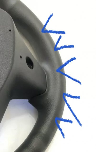

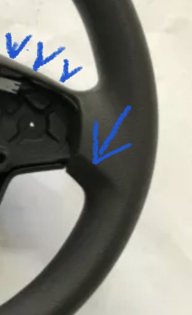

What are the "weird angles" that you sanded off from the SE steering wheel?

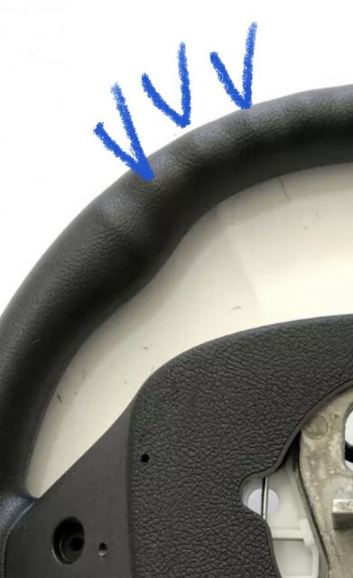

if you get a chance to see/hold the SE steering wheel, with hands 9-3, the thumb areas have some angles not on the ST wheel. The other place is the back side radius near same locations, and the finger grooves are too pronounced if recovering, causes issues with cutting material and stitching, and aren’t needed as pronounced. No pictures other than what was in first post.
OK so the wheel is covered and installed now, but I can “sort of” illustrate on the pictures from the listing... keep in mind that any irregularity will prong through the cover, I learned that trying to shave and recover motorcycle seats.
