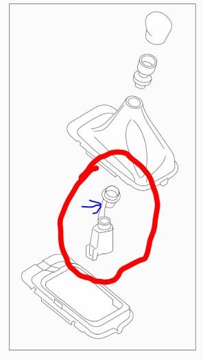

So I think this is where my problem is.
When I grab the boot, I can feel the plastic strip (with the blue arrow) and when I pull up on that, I get reverse. But when I use the ring only, I don't. I'm assuming that it somehow isn't connected to the shift ring completely.

Ok - maybe when you removed the OEM knob, you dislodged the retainer somehow. That's the only logical explanation...

Ok - maybe when you removed the OEM knob, you dislodged the retainer somehow. That's the only logical explanation...k
Yes, he can turn the boot inside out and check that.
Of course the boot must be removed first.
