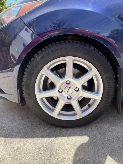

3 door should have identical wheel wells as our US 5-door. In any case, with 16” winter tires, 195/50R16 will definitely fit, and as long as you don’t lower the car, 195/55R16 winter tires will also fit, (which also gives some slight extra ground clearance over the 195/45 you were talking about). Both of those sizes have good options, especially the 195/55 (which is a BMW and Mini factory winter size in Europe). If you don’t already have wheels, 15” rims will also fit over the stock brakes, so 185/60R15 (and possibly 185/65R15) is also an option
The TS870’s are an excellent snow/rain/slush tire, they are decent on ice, but if you get a lot of icy conditions you may want something like the Nokian R5 or the Conti Viking 7

If you stay at stock ride height, I’d go with the 195/55R16 tires - I’ve been quite happy with my winters in that size and it gains you almost 0.5” of ground clearance switching from summer tires. If you add mudflaps, you may need to put shorter nuts on the front attachment studs and trim the studs a bit.
The ST is already lowered from a factory Fiesta. Because of the econobox suspension design (especially in the front), lowering more does not really improve performance, and can actually increase body roll slightly if taken more than about an inch below stock. Personally I prefer the “wheels centered in the wheelwell” look over the “eliminate all fender gap” you get with lowering springs.

Regarding the mud flaps, it’s not a standard thing, just something some people have noticed.
Attached a picture of my car with the 195/55R16 TS870. In the closeup of the front you can see the two mudflap nuts just behind the front wheel (pic is after I shortened them). The nuts that come with the rallyarmor flaps are about 1/8” (3mm) taller, and the stud sticks out slightly past them. Clearance was about 5-6mm before trimming which made me a little uncomfortable. Now it’s a solid 9mm gap from the tire
Ah, I see now what you meant!
