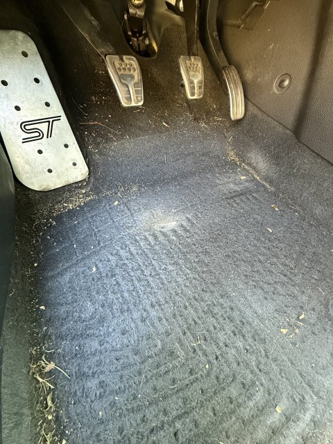

I must have sharp heels because I wear through floor mats like it's my job. It's so bad that I've worn through the carpet too:
