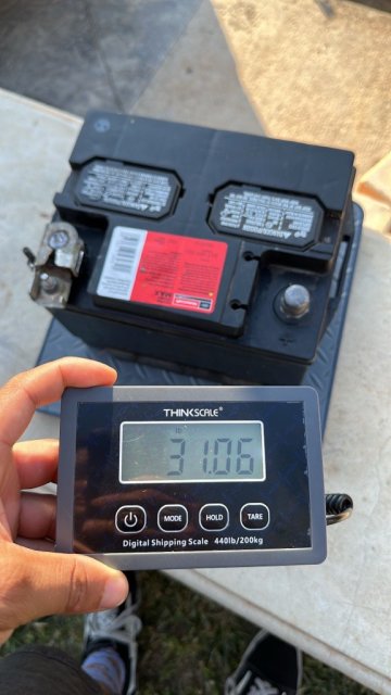

Holy cow, 28lbs is a lot. This just got moved to my bucket list.
I have mine in the spare tire well with a cut off switch at the center console (track dedicated). Frankly, it was a huge PITA, but moving the weight to the back is always good in this car.
Of course, making it 3 lbs instead off 31 lbs is probably better :)
These batteries are so light. They have batteries in the 1-2 pound range but I figured this model was best for me with the restart feature and more cranking amps than oem. I think if I moved the battery to the trunk I would easily add more weight in wires than the battery lol

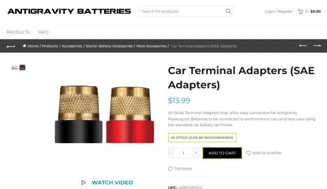

Which terminal adapters did you use to get this to work? Also you have now inspired me to get this battery and try to design a battery box and battery hold down that mounts to all or some of the factory battery box mounting locations. It will be a while but I will be collaborating with a friend of mine who has a 3D printer. I already made a battery hold down but its much to big for this small battery.
I used the ones that antigravity offers on their site:
https://antigravitybatteries.com/pr...ttery/cables-parts/car-terminal-adapters-sae/
