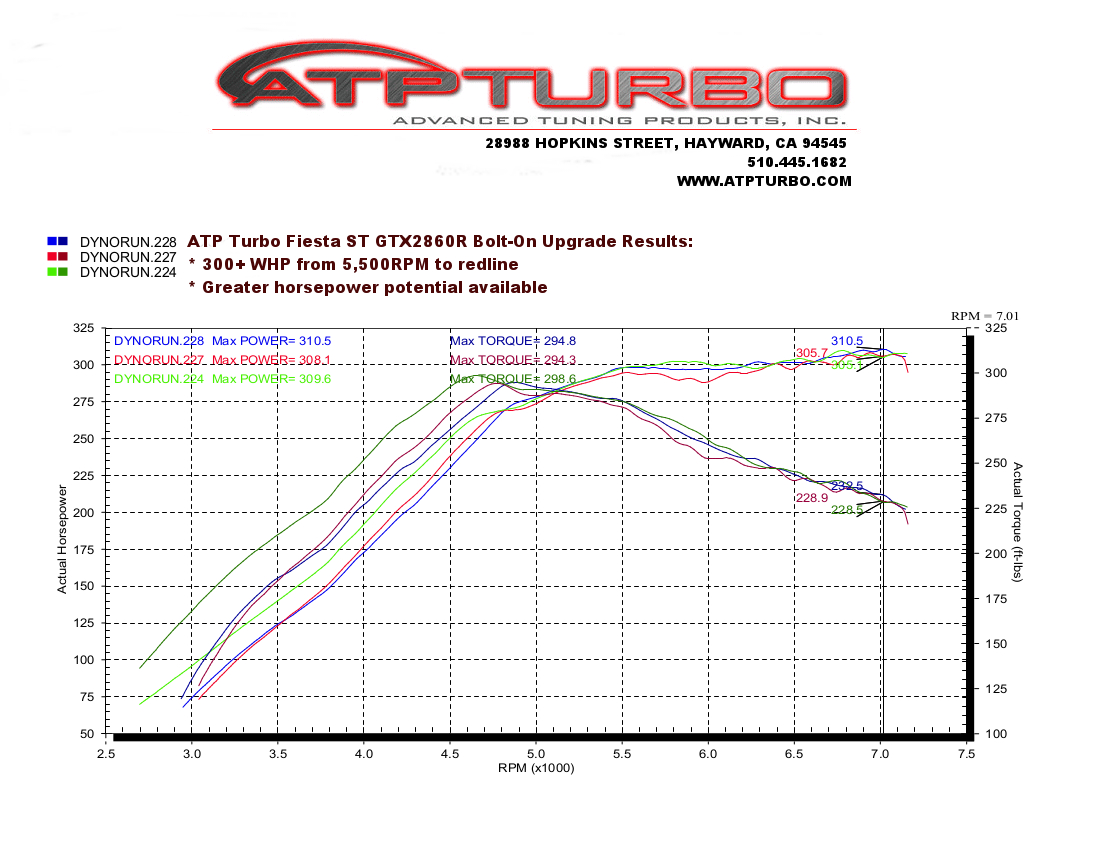

I know this info has been posted on the web since May but thought it might be helpful / useful to see 2 different Turbo upgrade paths verses actual dyno results verses 1/4 times posted...
ATP Turbo Fiesta ST Stage 3 GTX Turbo Upgrade achieved 12.4 sec at 110+ mph quarter-mile drag time...
Performance Upgrades:
- ATP Turbo Bolt-on Garrett Stage 3 GTX Turbo Upgrade
- ATP Intercooler
- ATP Downpipe
- ATP High Flow Charge Pipe (Hot Side)
- Cobb ATR Tuning File Rev. C. by Braden

I still think I'd prefer and would be very pleased with either the GT2554 or GT2560R though...
ATP Turbo Fiesta ST, 265+ whp & achieved 13.0 sec at 104.91mph quarter-mile drag time

ATP left a lot of mods out of the list. Not trying to nit pick here, but... The car has mods they don't mention to the car that ran 13.0-13.40. I ran 13.3@104mph with a 2.1 60ft time. With slicks and this instant power turbo, that's an easy 12sec run.
Here is the thing.... I don't think ATP gave the GT turbo its fair shake. I think with the right setup, it can/will do much better. If I can go 13.3@104mph on a turbo with a 38mm turbine wheel, I have a hard time believing they couldn't do almost any better with a 45++mm turbine wheel. I think they just got it running well, and then moved to the bigger turbo(s). The entire everything cyborg turbo is $1400.00. That's around 1/2 the cost of the REAL cost total of an ATP total turbo setup. So its not I want to dis-credit of talk down to the ATP. For me personally.... This car is freaking awesome the way it is with 230-245+whp and instantly response and stock-like reliability. But I would like to see some OTHER PEOPLE go the ATP route and EFR route, it just isn't going to be me. Spend a little time under the car looking at the axles, hubs, and general size of EVERYTHING and tell me that looks like a setup meant to handle 300whp for 5 years, lol.

looking at the torque curve from ATP, it looks like my turbo spools as fast as the GT turbo.
The tubular manifold is probably the reason for that.
I have full boost at 4000rpm. Is that not also where I have full torque? Whats the relation between torque and boost?
I have only 1.4 bar so its not exactly full boost for the turbo, but its comparable to the GT turbo right?

That's not much boost on that turbo. Are you just trying to keep the power down? Is it limited by octane ?
A long long time ago, an Incredibly reliable source told me ATP was running 28+psi on there GTX car :)
Datalogs would be nice, but I think right now, cobb access tuner is the only option for that I THINK. Can the euro cars do datalogs? I'm LOVE to see all the info on one of those cars. Just general timing , air mass flow, charge air temps, boost, rpm, coolant temps.

And yea, good call on the manifold helping with that spool. Honestly, I'd think the stock manifold ported would spool better than a tubular one. That being said, me of all people understand that's not always the case, and if pumaspeed says it spools the turbo's faster, then... It likely does.

No its not a lot of boost on this turbo, 1.4 bar, pumaspeed is working on a high boost tune, should be ready in a few months i hope, so im waiting on this.
I've searched for a tuning solution like cobb, but it doesnt seem to exist for the 2013 model.
I'm happy with the power i have at the moment so no rush. I have some logs with Forscan, I can log most of the important data, but timing corr. is missing,
The total timing also looks pretty safe for the stage 4 map, compared to stage 2, and i was also told it was a safe tune. That's why i suspect it might be less than 260whp.
I could post some logs later on.
28psi? 1.9bar thats a lot!
