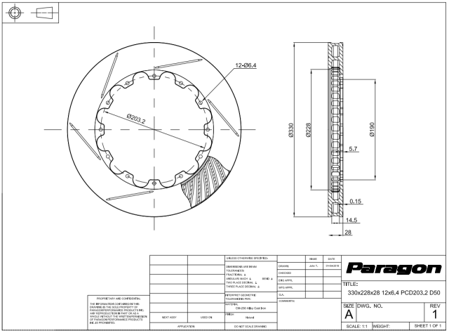

I wonder what the bolt pattern is on your rotor and hats? Think your pic shows a 203.2mm.
http://www.reyland.co.uk/fiesta/
I dug around a little on Paragon's website and it would appear 203.2mm is correct.
I'll confirm with a set of calipers next time I have a wheel off, likely in a week or so.

Thanks. Pretty sure those are the right rotors for me. The measurements I got off the "kit" I have here were a little different than those, but Based on what Reyland just said was their part number, I think Paragon has me covered.

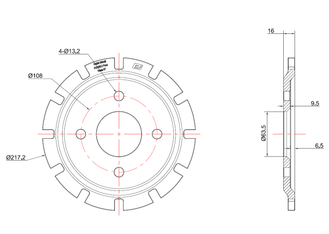

Got a diagram with some basic dimensions from Alcon for the hat. Some dimensions aren't shown, but appears to be to scale, so one could find them get them if inclined to do so...
