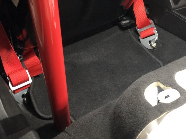

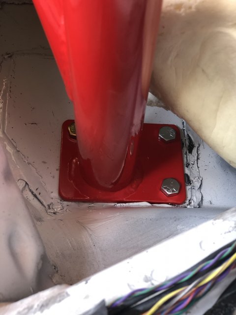

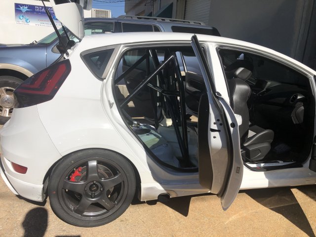

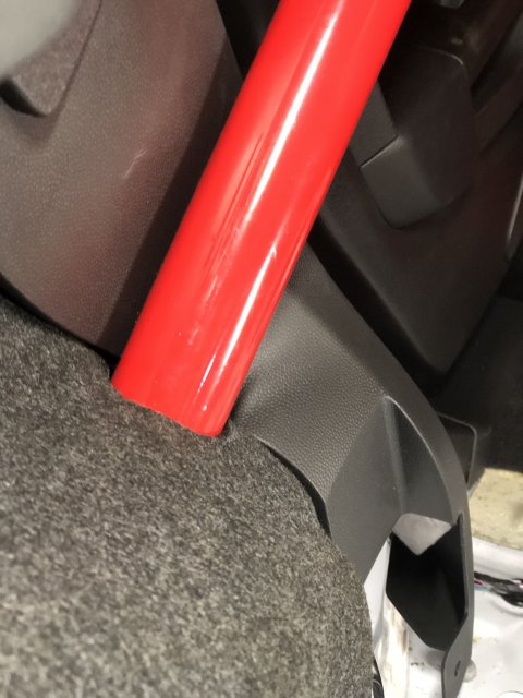

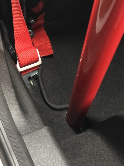

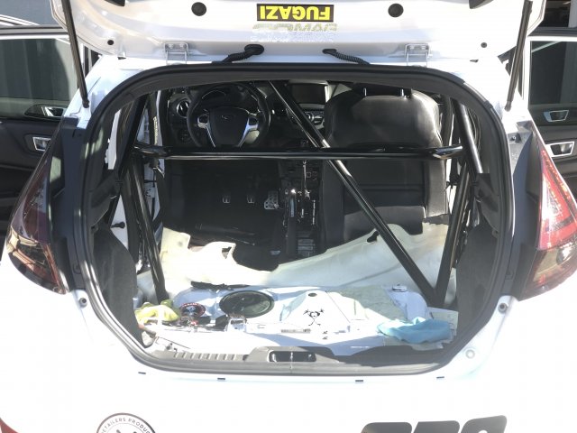

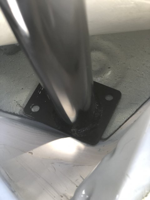

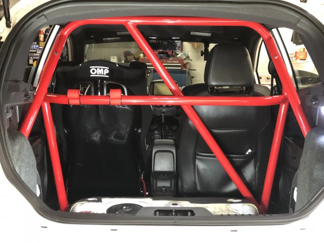

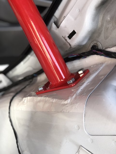

Mocking up mine today before powder coat. Fitment is absolutely perfect with a sunroof car. I’m seriously impressed. I removed the driver seat and console to install it. Do yourself a favor and take them out. It makes it so much easier. I’ll post an update again after it’s powder coated and permanently mounted.

Ah gah dang it - stop making me consider buying more stuff for my car!!!!
I never use them back seats anyways... Can a doggo / flat floor be made around the rear bars??
After seeing one in person I don't see why not. I'm in the same boat with the back seats. I have the lower tray that goes over the spare and the back lower bench so it doesn't look so bare. I would put some padding on the lower section of the bars if you did plan on transporting dogs. I have a 2 y/o 95lb Pointer/Dane mix and she would still have plenty of space with the bar installed

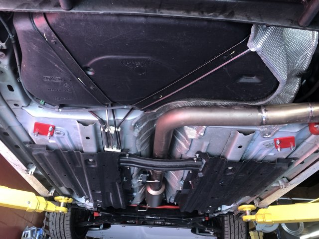

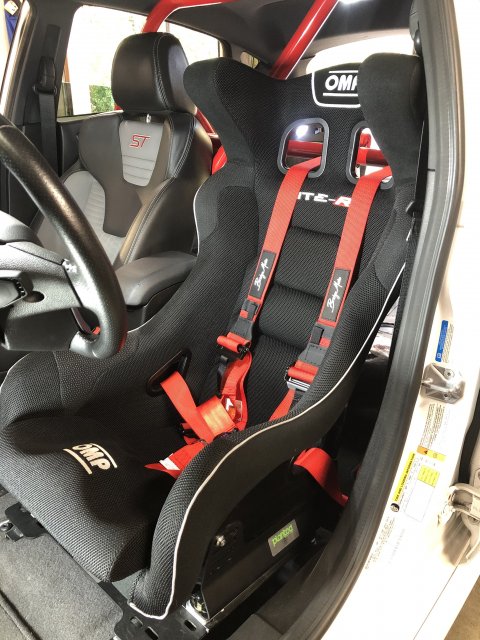

Can I make a suggestion? Remover the bottom plates underneath the floor (outside) and fill the bolt holes in with silicone (put the bolts back thru while the silicone is still wet), and silicone underneath the plate as well. These cars are known for rust issues, and you done want any water trapped in between that plate and the floor of your car.
Also, you might want to look into upgrading those harnesses to some cert'd belts. If not, at least safety tie those latches that are on eye bolts. (That's actually a requirement)
Bolt holes were painted then sealed and belts are certified. It’s done correctly. They have safety latches.. I don’t buy cheap shit lol.
I think what he was saying is the little hole on the latches need to have a pin or tie piece through them to hold them closed.
I know its a requirement for Champ Car and LeMons so i assume its required for SCCA/NASA events also.
