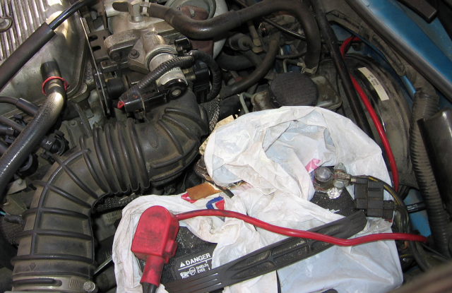

Every leak-acid battery I've ever had in the prior and current vehicles have put acid in the battery tray; and because they were both Fords that tray drained onto a ground wire conveniently placed beneath the battery tray. (went through three alternators in the prior vehicle because of that)
AGM weren't invented or available at the time so what I started doing was, bagging the battery.
The bags designed for hot foods, are heat resistant.
So bags from chicken places like PopEyes, KFC, Churches for instance, did the job nicely.
Just be sure not to block/cover the battery vents.
In the bottom of that bag, was baking soda. (neutralizes acid)
Started covering the terminals with engine oil and sprinkled baking soda on top; which stuck to the oil. The sanded surfaces of the insides of those clamps kept their nice golden-copper color.
