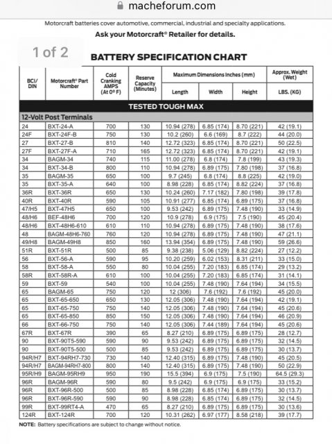

Does anyone know if the motorcraft BXT96R590 and BXT96R500 both fit the original tray without a spacer or something dumb like that thanks? Both are about the same price so I don’t know why the 500 is even around if the fit is identical. Both are the same group so I figured 96r group would be the same. Thanks!
58
17
Boston
The 590 is the same dimensions but 32lbs vs 30 for the BXT96R500
58
17
Boston
Thanks. What’s weird is per Mitchell1 the 590cca is actually for the 1.0 whereas the 500cca is oe for the ST. No idea why. Maybe the base fiesta in auto has stop/start? The 500 is the factory spec for my March 17 build and still going but we have heat coming this week so i figure it will go at some point this summer finally.
