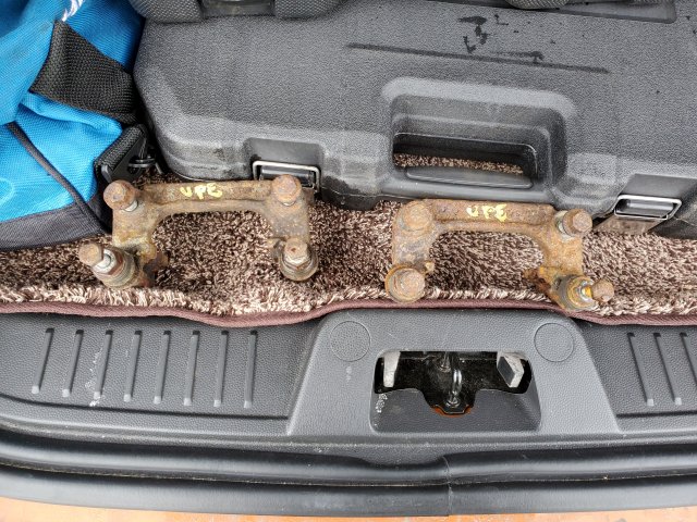

Also... I took a trip to the local car parts yard at lunch and found a unicorn focus svt with brakes still intact! Brought my tools and thought it would be a quick job but unfortunately the pistons were seized, and they are rusted to shit so a ton of prying and swearing later I have the first part of my brake upgrade.
Anyone have any tips on cleaning them up and repainting them, also the where can I find the slider pins and boots to replace the old ones?
Your ST slide pins and boots will work just fine with the svt bracket 😃 congrats on the find
If it was me....I get them blasted and powder coated! Lucky Duck!
TDavis' Platinum Warrior build
Restored the SVT rear caliper brackets to their formal glory after an acid bath and polishing. Also painted the rotors as the factory Ford ones do not come with a black rotor hat.
Check out my build thread. I used some Evapo-Rust and a wire brush on a regular hand drill to make them look new
