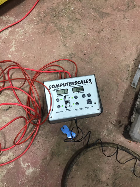

I disagree with that on our platform, I will take another picture with the car on the scales to show how out of wack the weight distribution is on our cars. Prior to the off-season I was roughly 855lbs in the rear and 1600 and change on the front tires. That 70ish/30ish weight distribution paired with to much front brake made nose dive extremely bad and took even more of the weight off the rear tires under hard braking making the car extremely tail happy, borderline having a hard time catching the car when pushing 10/10ths on track. Rear SVT rotor ( nearly a 1in larger) and going from the low dust to high dust rear pad fixed this issue making the whole car plant under hard braking

63160679-F432-40CC-9621-3D4F276D09F0.png shame on me I only took a picture of total weight from last season. Will take new ones after the car is done this off-season of cross weights and front to rear weight distribution.

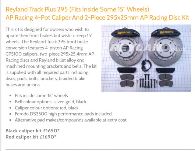

Not trying to jack the post, but I’m currently looking into the Reyland AP kit that they claim fit under “some” 15’s.. that’s a must for me as I have 2 sets of TD pro race 1.2’s and I think the 15’s benifit this platform a lot. My biggest gripe with the vmaxx kit is lack of rotor choices as I feel the slotted rotors were contributing to some of the issues with brake pad material building up and haveing such bad pulsateing. If it does, the vmaxx kit will go up on the marketplace and I’ll run the hair larger J hook rotors and AP calipers that vmaxx seemed to try and replicate. ACBFC52B-08B3-4FA9-BE5B-4DFBA36B1503.jpeg

Not trying to jack the post, but I’m currently looking into the Reyland AP kit that they claim fit under “some” 15’s.. that’s a must for me as I have 2 sets of TD pro race 1.2’s and I think the 15’s benifit this platform a lot. My biggest gripe with the vmaxx kit is lack of rotor choices as I feel the slotted rotors were contributing to some of the issues with brake pad material building up and haveing such bad pulsateing. If it does, the vmaxx kit will go up on the marketplace and I’ll run the hair larger J hook rotors and AP calipers that vmaxx seemed to try and replicate. View attachment 27943
I'd say go for it! I'm pretty sure they will fit because the TD's usually have the most room for brakes out of any commonly available aftermarket wheel that fits on the Fiesta but I'm sure you can get a mesurement from them to make sure. The kit I have is great and the machining was top notch so you definitely won't be dissapointed!

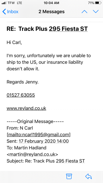

Who did you go though? I was just told they don’t ship to the US for insurance reasons? Smh A81E4753-5F81-435E-A594-531CEEEB279B.png
