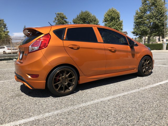

Just take that stuff off of there for factory paint underneath 👌 Cheap, easy and satisfactory look. Just a suggestion. If you decide to go that route use a heat gun or blow dryer... heat them up and peel off with tweezers/fingernails/razor blade. Take your time with it. Will take about 2hrs. Cut the vinyl behind the rubber jam with a razor blade for clean finish. Either way, you’ll need to remove them to rewrap regardless. I would suggest taking them off first... see what you think, then choose to buy new wrap or not. You don’t need to buy vehicle specific overpriced “trim pieces” either. You can just buy some vinyl in whatever color you want and wrap + trim yourself. Hope that helps.

No, I think it looks terrible to have body color around the glass. Way too busy
I wouldn’t quite go terrible, but I don’t like it for sure. When the dealer I bought my car from got it, it had some of those damn wind deflectors on that they tried to remove and peeled parts of the vinyl off. I haven’t committed to buying replacements yet but I think I will eventually.

I think that looks rad! But that’s just my opinion. Was your paint orange peel or scuffed under it at all?

Not Orange peeled, nor scuffed, BUT peeling the vinyl off, they peeled off a couple real small chips. I think they were trying to rush the job. But overall, the paint condition is basically as good as the rest of the car
