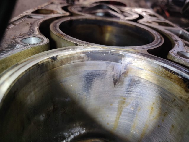

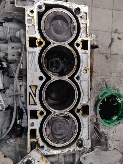

Never thought this would happen to me. But 81.000 miles. About 15.000 miles on an X47R.
Closure on the deck, cracked liners, valve cover gasket failure in cylinder 2(hence the oil).
It sucks, so now I'm probing PumaSpeed for a suitable replacement. Maybe a refurbished or redtop block to cope with the X47R on a daily basis as this is my daily driver.
View attachment 25167 View attachment 25168

Symptoms started with a hunger for coolant and then things escalated to intermittent misfires especially above 3k RPM on load and overheating(even on my regular commute with a max speed of 50mph and regular start/stop traffic). Cranked the heat to control the coolant temp till I could stop and cool it down.
I changed spark plugs which seemed to remove the misfires for a time(before the overheating began). But it came back.
In the end it overheated for one last time on my morning commute. No power and I limped it in first gear to a parking lot from where it got collected. Wouldn't start after that. Checked for spark and there were loads, it cranked fine but sounded hollow and no compression.
Result: compression on cylinder 1, 3 and 4 were all but non existant and the resulting mess in previous post.
