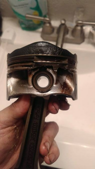

Previously had a ring land failure (cylinder 4) with an X47R, aux fuel, mishimoto radiator and ethanol tune. Just to note I was experiencing overheating in the middle of the summer in Arizona while running the car stock PRIOR to modding the car. Bought and installed a mishimoto radiator which solved the issue...then began modding from there. I rebuilt the engine with forged pistons and rods from mountune and everything has been goochi. Beat the piss out of her with the stock turbo for six months.... and now I'm back at it with an upgraded S280 turbo :) .
What were your failure symptoms with the x47R? What led you to believe it was ring land failure....Etc.
#10197
61
68
Any Ap3 reading that were funny? Etc
No symptoms, just flew off a chunk of piston during a pull and began eating oil. It threw some code that I do not recall but I ended up looking at the spark plugs and seen oil on the spark plug for that cylinder. Pulled it apart and found that.

I just blew my fist motor. Cylinder 4.
More details would be nice. Turbo, tuner, mileage, what occurred before it blew? Failure mode, etc..
JDG
#6691
1,863
1,995
It was that crackle n pop tune
Not nearly enough information being provided. Starting to sound like a troll. Also very bizarre first post on the forums..
#11734
5
Stock turbo. Full bolt ones. Had a pop tune from stratified. Melted cylinder wall n piston right past rings. 77k on motor
