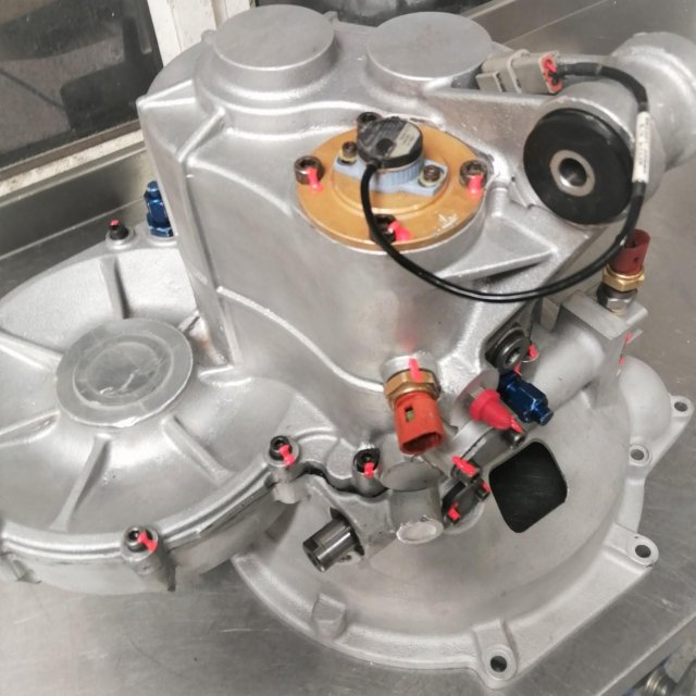

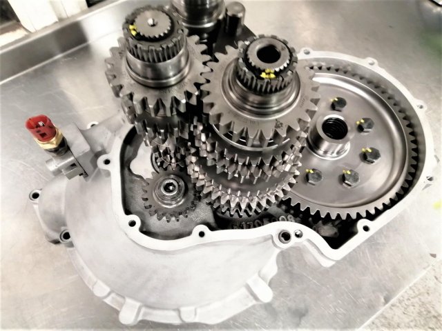

Here is one for sale for $3300; that's way less than I paid for just my turbo kit, and it's freshly rebuilt too!
http://www.racepartstrader.com/listing/fiesta-r2-sadev-sequential-gearbox/
I have contacted M-Sport about pricing and ordering custom ratios, so I have something better tailored to the street. The Sadev R2 transmission is a 5spd with 1 reverse gear. It wouldn't be hard to
integrate an aftermarket throttle cut/spark cut potentiometer.
If this doesn't end up working out, I will probably swap drivetrain setups and go AWD. It's a big project, and I've never modified anything that extensively, so id rather see if I can get this to work first. I've also attached some really cool documents relating to the R2 transmission.
