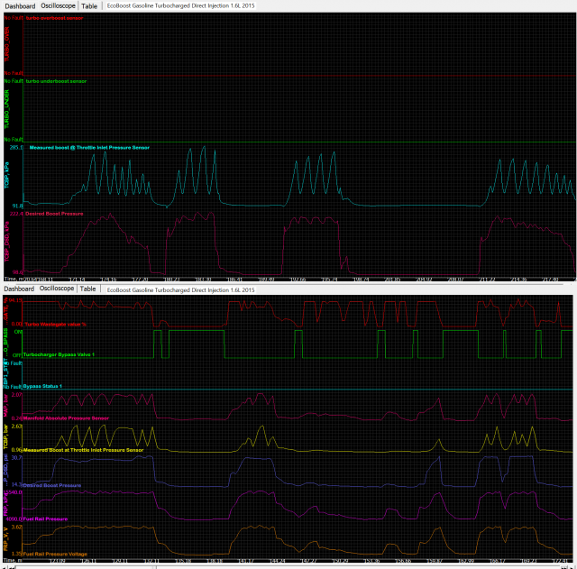

I was about to make a thread but my symptoms are very similar in my Transit Connect 1.6l ecoboost. Been running forscan, no codes coming up, but basically...
>2000-3000rpm, noticible stuttering in power
>religious oil changes at 5k km
>transmission fluid changed
>air filter changed
>spark plugs changed
>fluids checked
attached are some forscan readings
