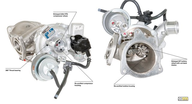

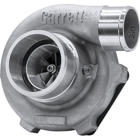

If you are planning on going big turbo, you need a true blow off valve. You have to install it at the symposer location and use a blank off plate at the stock diverter valve location. A diverter valve style bov is useless with a true big turbo like a GTX2860R.
Why is the diverter valve considered worthless on a big turbo? My buddies Mazdaspeed 3 used a diverter valve on the stock turbo which, is a K04, compared to a KP39 is massive.
slopoke
649
640
Livermore
#38
Because it won't fit. A stock type diverter valve fits on the turbo. A true big turbo does not have a diverter valve mounting point on the compressor case. You have to use a blow off valve.
turbo-garrett-gtx2860r-gen-ii-849894-5001s-super-core.jpg Mountune-Ford-Fiesta-ST-turbo-upgrade.jpg
DoomsdayMelody
579
464
San Jose
#39
View attachment 34321 View attachment 34322
Interesting the DV on the MS3 feeds off of the top mounted intercooler and dumps right back into the intake, I had no idea where the FiSTs DV was, so TIL.
