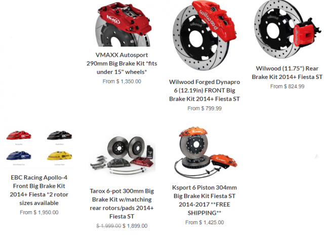

There are quite a few big brake setups out there. Below are the ones that Whoosh Motorsports sells but there are others. There is quite a bit of fitment discussion here on the forums, knowing what make/model/size of wheel you are running can make a big difference here.
I personally run a kit that pushes the stock calipers out from Gold Coast Automotive: Link Here for the fronts and brackets to do the same for the rears from a SVT Focus.

The Apollo seem to be the easiest Fitting Kit from talking to a EBC Emp.Whether it be stock wheel or Aftermarket wheels.
