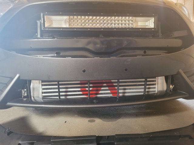

Here are pics of what went back on, in regards to the front bumper cover. All I can remember is that it took a bit of pulling and stretching some plastic to make everything fit.
View attachment 37434 View attachment 37435
And the two plastic hanging pieces of the splash guard reached up to the crash bar for you? Huh
Yes, those ones are what I'm curious about. I figured it would take some force which I'm ok with because that stuff doesn't move much under engine movement. @Kinnaird are you talking about the 2 little straps? A lot of people trim those just a bit to fit large IC's like the whoosh V3, etc.
The two straps that go up, Yea, because those don't reach down to the bottom of the ic, i could cut those off, secure the backside of the splash guard to the ic etc, and the front bumper, just wasn't sure, also didn't think about that until now, i thought those had to connect to the crash bar

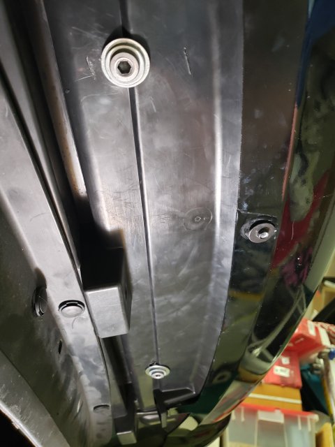

Clever move deciding to cut a hole and actually using those threaded bosses fasten it down
Just more stuff to un-bolt* Thats my view of it. But it doesn't hurt thats for sure!

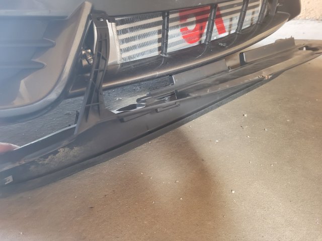

As promised, attached are the pics of the piece i couldnt reinstall. The second pic focuses on the arms that went up to the crashbar from beneath/in front of the intercooler that are too short now to put back on.
I see ....its the strap. That went the way of the DODO after my Whoosh intercooler was installed as it would no longer fit also* So....in the end i cut that off just like it was 127 hours.
Lmao Yea I'm thinkin next time cut off them little nubs of arms and just let it kinda float in there, right now i got the lower bumper zip tied to the car to avoid movement haha, fuckin zip tied are great, they're also holding in half my radiator bleeder screw as part of it broke during my mountune radiator install haha
Yeah I've done what others have already done. When I installed my Whoosh V1 intercooler I just cut those off. Doesn't affect how the splash shield is placed
