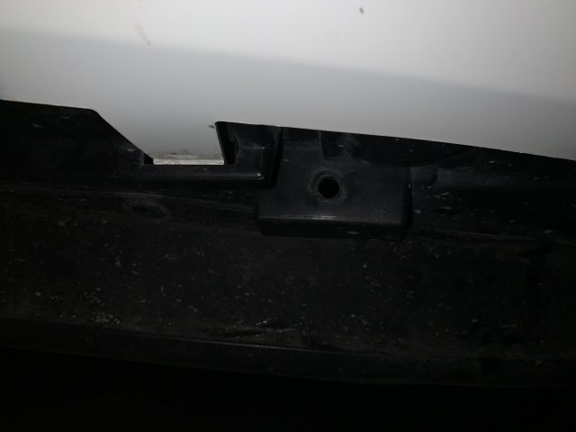

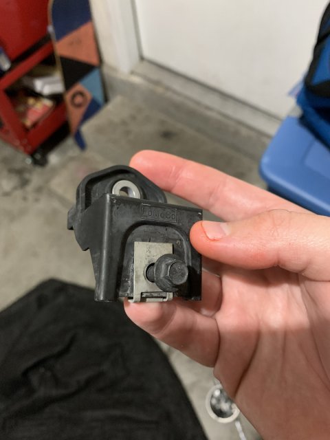

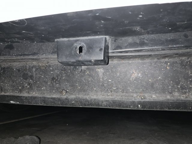

For those that have done this install... were you able to attach the front splash shield screws? If so maybe my crashbar is aligned too low. I had to remove the middle plastic bracket shown and none of the three bolts align now for the splash shield to bolt to the radiator support. Still kind of attaches but the IC currently hangs too low to line that up.
