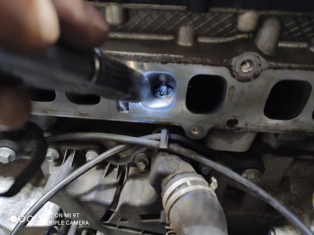

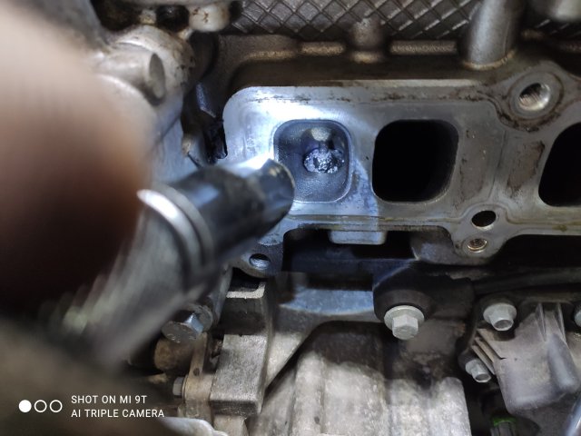

First, i would like to apologise for the fact that i did not do the case study on a "clean" subject. With un-clean subject i mean that the car is not completely stock and i have used a CDC valve cleaner product prior to disassembly (2k miles back. However, if you read the results you will see that this did not effect the conclusion in any way).
To test both hypotheses i had to take off the intake. So, that's what i did.
The guinea pig for this test was a 2014 Fiesta ST 1.6 Ecoboost with a bit above 60k miles, stock tune and Airtec intercooler. Full maintenance history. Vehicle has been mainly used by me and by previous owner's for spirited driving and auto cross. I estimate 60% of total miles to be of the highway variety. First
Prior to disassembly vehicle did not show any significant indicators of running rough. The only thing worth mentioning is rough running after sitting for a week+ the first minute.
Results
Bad. Based on the VAG video's the carbon build up on the Fiesta is comparable to the VAG counterpart. I mean, see the pictures.
1: Fords do absolutely suffer from carbon build up. Again, see the pictures
2: Absolutely NOT. After cleaning, i directly noticed that the car ran much smoother and had more "oompf". I think reason why i noted prior to disassembly that the car did not run rough was because it didn't. However, not running rough is definitely not the same as optimum operation. While you could claim that my conclusion can be caused by placebo effect, i would counter with my butt dyno. I definetly noticed a difference.
3: For cleaning valve's, this stuff is useless. Again, see pictures. This is after the treatment. This means that either the valve fouling was ever worse, or it can only help when valve are clean to prevent future build up.
Summary:
While this is only a case study my car clearly shows that fiesta's suffer from carbon build up. And while not causing catastrophic damage, it prevents the engine from running optimally. I would encourage others to research this issue further and possibly expand the literature with case studies of long term usage of catch cans and different types of driving styles.

Carb cleaner. Spray into closed valves, take a smoke break, nylon brush and suck the slurry out. Repeat 5 times. First I used compressed air but learned quickly that even with protection that stuff is so aggressive it burned like hell on my skin. So sucking is best.
