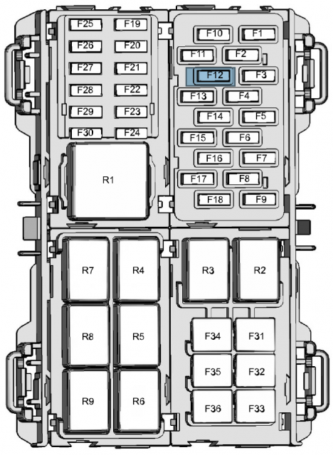

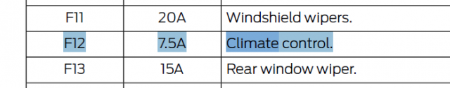

I've checked the fuses and nothing is blown there at least for Fuse #12 (if I remember correctly). The only thing I've done recently was run a remote power wire from the instrument cluster fuse (Fuse #19 I believe it was, 2nd from the left on the top, left bank inside car).
What would cause my climate controls to turn on and then off shortly after when starting the car?

Apparently using the Climate Control fuse can cause these issues, going to swap the inline fuse to the moonroof fuse and see if that solves it.

Just for future reference if anyone has any issues like this, it was indeed because I was using the cluster fuse, swapping to the moonroof has seemed to fix the issue

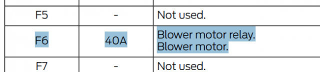

My blower motor wouldn't work at all following an oil change. Obviously changing the oil has zero to do with the climate control system so it was pure coincidence.
Worked after reseating the blower motor relay underneath the hood. Did it again like a year or so later.
Same thing fixed except, this time I replaced the relay, worked it in/out to rub off any possible layer of corrosion and added a little dielectric grease for the connections.

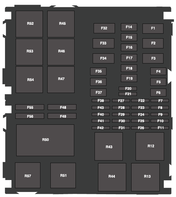

I don’t know why they are calling it (F6) a relay, it’s really a high amp fuse. Cleaned and dressed it with dielectric grease, haven’t had time to see if it works, been finishing the hood and front clip from a deer suicide

Hadn't even noticed until you said something. 🤔 It's been awhile. I thought I was messing with one of the large square things... not the small rectangular ones.
(looks at manual again...)
Ah okay...
