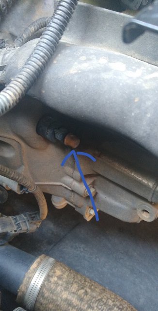

Is this the clutch bleed valve?
I've been looking on YouTube and can't find a good video showing how to bleed this clutch. If I actually knew what I was doing, I would try to make my own video.
11,817
8,288
That is just the bleeder cap* take it off and that is the bleeder *
