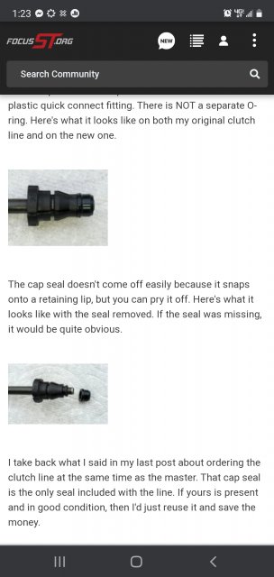

They wouldn't cover it under warranty for me. But its pretty easy to change out yourself. As well as reverse bleeding the system. Just be on the lookout for the nipple on the bottom line. It's likely to come off and cause leaks.
