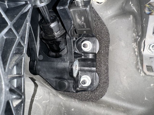

Hey guys, I'm looking for some help/advice. To preface, I have a 2017 with 45,000 miles.
First, I noticed fluid dripping behind and down my clutch pedal (see pictures). With the leak, the clutch and everything still worked fine.
I had a shop replace the Master Cylinder, as this is what people online recommended. And they bled and replaced the fluid. The leak is fixed, but now the clutch only comes back up about halfway. Clutch still works, and the car drives, but it feels super weird.
I took it back to the shop they reinspected it. To fix the clutch issue, they are recommending replacing the Clutch master cylinder. But the issue is, I can't find the part anywhere in America.
Why would the clutch pedal start sticking after replacing the Master Cylinder and fixing the leak?
I know this could also be a Slaver Cylinder issue. Is it worth trying to replace the Clutch master cylinder/pedal before committing to the slaver cylinder?
Any advice will be much appreciated.

Hmmm. I would have replaced the clutch master assembly based on the leak but if the master cylinder replacement resolved that leak....its very possible there's still some air trapped in the system possibly the shop didn't bleed it well.
I mentioned bleeding the fluid again to the shop, and they said they didn't see any air bubbles. Not sure how they would see them lol.
Would you say it's still worth trying to replace the clutch master assembly?

If it were me in your particular situation, I would bleed the clutch again myself first. Then if the issue persisted, I would then replace the clutch master assembly, (praying it's not the slave)
Currently I have the same pedal issue, minus any visible leaks and purchased a pressure bleeder kit and a clutch master assembly (I suspect the clutch master order is going to be canceled) as every other place showed it as unavailable.
From reading every available source of info concerning this issue, it seems like the bleeding procedure can take a few tries to get it right. If a shop bled the system but didn't pump the clutch after and rebleed, air could easily still be in the system. In my experience most shops do shotty work in an effort to save time

Sounds like air in the system as others have stated. Try a pressure bleeder. That seams to be the hot ticket on these.

I agree. I’m going to bleed to the clutch with a friend of mine to see if that fixes anything.
I was somehow able to find and order a Clutch master assembly today. So if the bleeding doesn’t work, I’ll replace the assembly.

Reverse bleed or Motive Power bleeder with Forscan ABS module bleed*

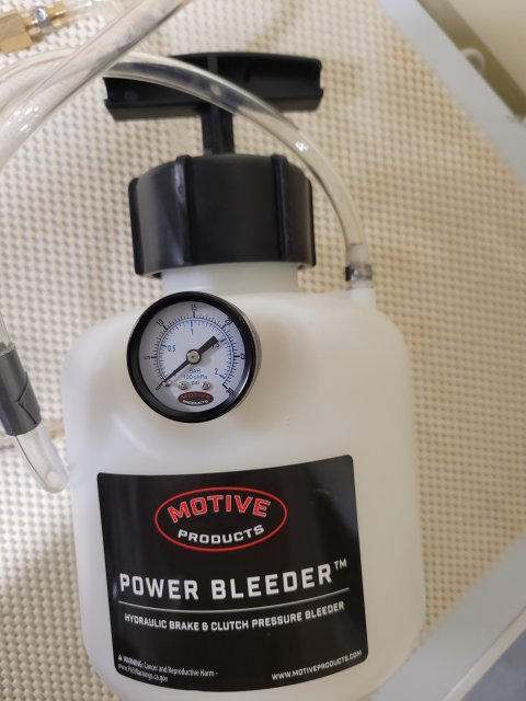

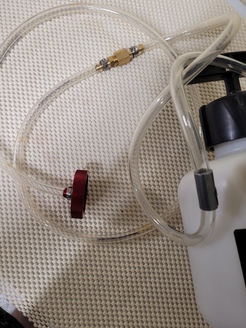

Motive 0118 didn't work. May be because it was obviously in used condition with someone's modifications still in tact. Anyhow tried holding pressure dry, couldn't get it above 10psi and would leak down in about 40 seconds so that just got returned. Even the little fluid catch bottle I ordered separately was received in an Amazon return bag lol. Amazon is so ghetto. Anyhow not sure what to do now.
I will say the red aluminum adaptor cap did have a nice tight fit and locked into place well. Not sure where it was leaking but due to it being modified and used I just got rid of it.

Just to give an update. I reverse bled the clutch twice today, and the pedal is still sticking... :(
I'm going to replace the clutch master cylinder next, and hopefully that fixes it. If not, the slave is next.
