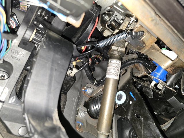

And for bleeding I don't like getting under my car so I just remove the air box and access the bleeder from there. Suck the fluid out of the brake fluid reservoir, then fill your syringe with fresh fluid and push it through the bleeder valve, repeat 3 times. I used this it fits our valve perfect
