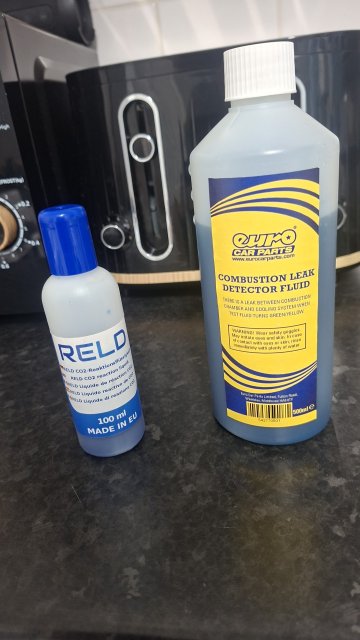

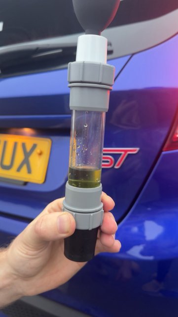

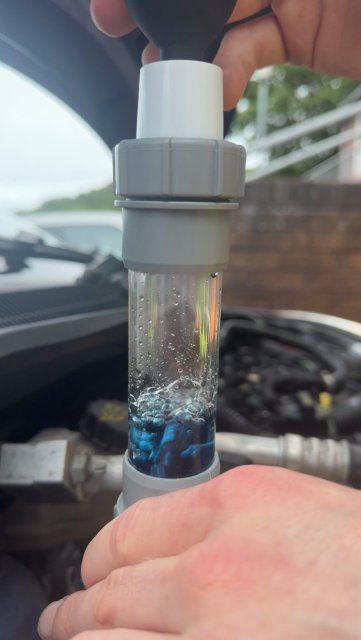

Mechanic done a leak test for me earlier and said the colour was fine (as seen in the 1st picture) but me being me i wasnt convinced so I bought my own and got 2 different brand tester fluids. Tried them both and both of them remained blue, I even tried it by the exhaust to confirm the fluid is working as it should and turned yellow ( also seen in the last picture)! Does this confirm for me that I have no bad head gasket, cracked liner/block?
