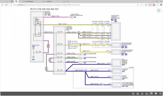

Bought a 2014 fist 2 weeks ago, everything was great. Last Monday car starts I drive 2 minutes and it just dies, it then throws these codes.
So I tried some troubleshooting replaced a corroded fuse and cleaned the contact area, and tested all the other fuses. No luck. Took it to a shop yesterday, today they got the car to idle for an hour and a half after replacing a fuse that controls most of the functions listed above apparently, but when they went to drive it it died immediately and they stopped. Im going to get the report tomorrow to see what exactly they did, but it's a bit disheartening so far. Any idea what would kill the engine after they started to drive it? I'll update tomorrow with the report.

Sounds like there is a short or bad connection somewhere in wiring that goes out of the ECU or fusebox. Check the grounds too.

get in there and look at the wiring harness for the engine. many time cars sitting waiting to be sold get rodent damage. This feels like that to me for some reason. check that harness for chew marks.
this is the circuit that has all those things 1747868147620.png 1747868198231.png fuse 24 in the battery box. that is feed by pcm power relay. seems like your issue is on the power side of splice 163. s163 is just behind the driver headlight. thats where i would start
