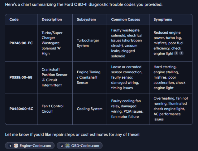

Hi everyone. Here's some news and a question.
I changed mechanics. I ran into a guy on the street who was a fan of the car and had a garage, so I left it with him. His conclusion is that the problem is electrical, with a signal getting lost somewhere. He tells me he's fixed the rattling problem, but now the turbo stops working when the engine warms up. Does anyone have any idea what could be causing the problem? I'll check elsewhere on the forum to see if anyone else has asked the same question.
Thanks for your support. See you soon.
