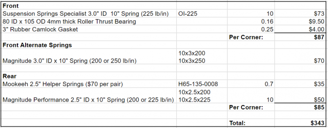

Parts List! (Edited with more options and links)
Here is a "budget" parts list I put together if you want to buy everything brand new as but as cheaply as possible. Note, the 225lb front springs I used were on clearance, so if you can’t find them cheaply, there are also some options in 200 and 250lb that can be had more affordably from Landrum (who mostly makes stuff for OEMs) and other companies. I also stumbled across Magnitude performance, which looks remarkably affordable, and is apparently made in Texas. I also updated the parts list, as "Viper Springs" has some very affordable options including the correct 225 lb/in option (No idea where they are made). Seemingly all decent alternatives to cheap questionable ebay stuff.
Links:
Springs: (need to select correct rate and choice of color for the two different ID springs)
Viper 3.0x10 225lb front (Need 2x): https://f-o-a.com/shop/viper-3-0-inch-id-spring-10-inch-length/
Viper 2.5x10 200lb rear (Need 2x): https://f-o-a.com/shop/viper-2-5-inch-id-spring-10-inch-length/

Mookeh 2.5" Helper Springs (1x sold as a pair - get the shorter 3" tall ones): https://www.ebay.com/sch/i.html?_from=R40&_trksid=p2334524.m570.l1313&_nkw=mookeeh+2.5"+helper+spring
(Pretty much any zero rate 2.5” ID helper will work, these are just the cheapest I’ve found)
Note, because this is sort of an experimental setup for me while I'm working on a more long term solution, I did it on the super cheap. I used SSS front springs and parts listed in the front (off Ebay and Amazon because I was in a hurry), but in the rear I scored a set of pair of off-brand 200lb coilover springs off ebay for $50 shipped. So who knows how well they are matched and how long they will last before sagging. I used a set of helpers I had already instead the "Mookeeh" ones (which are a brand I've never heard of off ebay)
Obviously, you can substitute higher quality components, but expect to pay significantly more for them. But for a set of "Rally Springs", the cheap ones are fine for now. One caveat with this setup is that the rubber camlock gaskets I used are 3" ID 1/4x1/4 rubber rings with a slight stretch (technically 10% is okay for rubber orings). They may be cheap, but they seem to be holding up
I could make a custom spacer ring easily, but that kind of defeats the point of the "anyone can do this" I was going for. A Poly spring isolator would be nice, but I haven't found one exactly the right size yet in the universal ones, and its hard to find details on the car model-specific ones out there. They’ll probably work fine with the other upper rings available

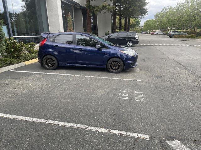

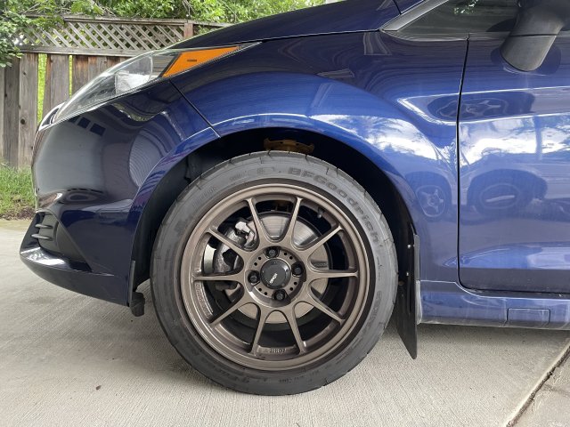

A little update - back to summer tires. Ride height looks stock. I expect it might settle a little bit over time.
The car feels nicely planted and settles faster going over bumps, and either I’m just imagining it or the ride quality has actually improved. It’s certainly firm but it feels less “harsh”.

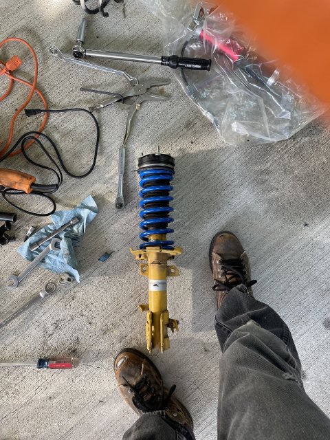

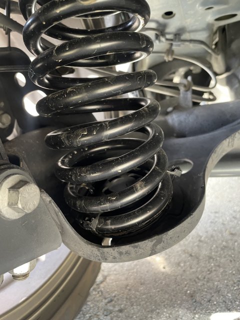

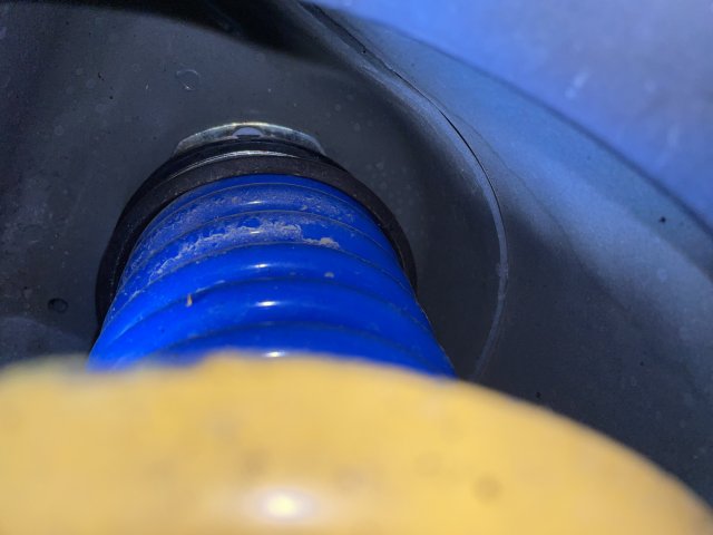

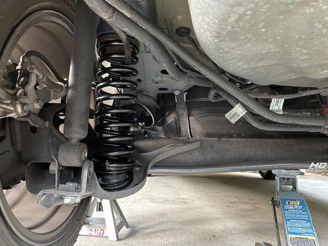

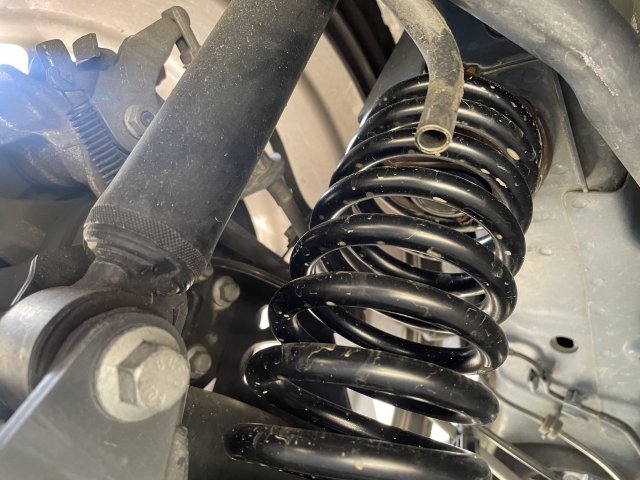

So I just poked my nose under to see how the rear springs are settling in - on the old stock rubber isolators, the springs sit a bit towards the rear of the upper spring perch. It doesn’t seem to really be a problem as it’s still fully on the perch, but I wonder if using a different isolator would make it sit more centered, as it may cause the stock isolator to get chewed up faster.
Either a whoosh/Powerflex polyurethane, or maybe just a universal poly isolator that doesn’t have a notch for the end of the coil (since the coilover springs contact almost all the way around, vs stock springs that only really contact in a part circle
Alternately, a 60mm ID spring might be a better fit, but that may limit your rate options to 3k or 4k stiffnesses (168 or 224 lb/in), unless you can find a 3.5k (196lb/in) spring which is a an oddball size and hard to find - only Eibach makes 2.36” springs in “standard” 25lb increments and those aren’t cheap.
it might even work with a 2.25” ID spring but it might be tight
The bottom spring cup seems more or less fine, but could also accept a smaller spring

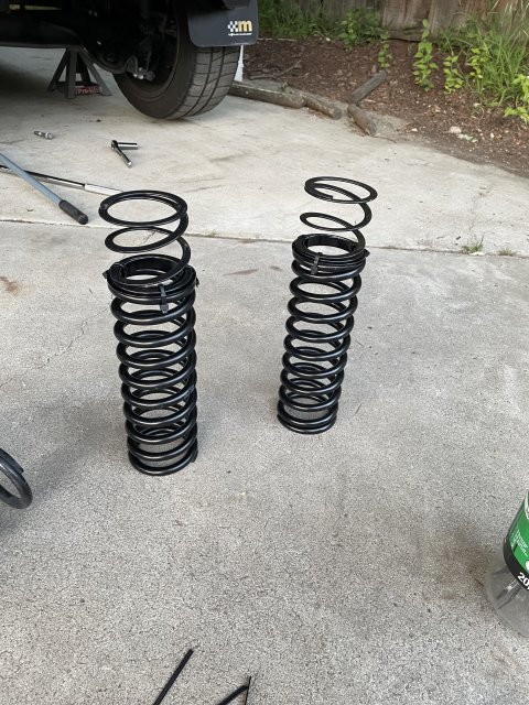

Thread Starter #9
Very cool, thanks for sharing this!
What made you use the helper springs in the rear, just extra spacing?
At droop, the rear main spring would be barely touching, so it’s partly the extra spacing to keep the rear springs preloaded and there’s also significant angle mismatch between the body and torsion beam perches that would cause the main spring to go banana shaped - the softer helper spring accommodates the angle and lets the stiffer coil spring sit more straight and vertical, less likely to pop out.
At ride height, the helper is fully compressed, but at droop you can see the helper is open at the back. Image below for reference is also in the first post.

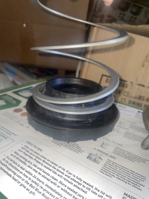

Do you think the 3" ID would fit over the stock top hat bearing? I see you used a fabricobbled setup with the roller bearing and rubber isolator but the stock top hat already has the bearing within it along with the rubber boot.
It could be a nice little setup to go with the 3" springs in an 8" length at 250/225 rates on the B6/B8 damper. A bit more spring rate to help eliminate roll without requiring adjustable coilovers.
Dialcaliper
Dialcaliper
#23994
1,100
1,769
Thread Starter #11
As I mentioned, the roller bearing and rubber ring are only being used as spacers instead of a helper spring which would have been too tall They just happened to be what fit well with the diameter of the stock plastic bearing.
The 3” spring is about 1/8” too small for the top hat because of the taper on the stock plastic bearing so it won’t sit all the way “up” on the flat. Ideal diameter for the spacer is about 3.25”
An 8” spring could be doable, but would require some additional spacer and a helper spring. It took me a while to wrap my head around it, but a 2” shorter spring of the same rate would result in a 2” drop, which is too much because the winding is different to get the same spring rate.
What I’d do is swap to a 9” spring in the rear (like the ones JEGS sells), and then keep the funky bushing setup in the front and add a 3” helper in the front, on an 8” spring in the front, but *keep* the rubber ring and roller bearing (or some other convenient spacer) in the front.
250/225 rate would add about 0.3” F/R height, so I’d estimate you’d sit about 3/4” below stock. I’d definitely recommend a stiffer shock like the B6, as the 200 I have in the rear on stock rear shocks (@60k miles) rides fine, but is on the bouncy side on the freeway.
I did find a reasonable affordable 3” Accutune helper spring - together with its coupler/slider (meant for off-road shocks), it adds about an inch of height. You can see how it doesn’t quite sit down on the bearing - the 3” main spring is similar.
The other option as I mentioned for a “rally” lift is B6 shocks with 250/225 in 10” length, which will lift the car just over 0.25” above stock ST height (closer to base model Fiesta, at least in front)

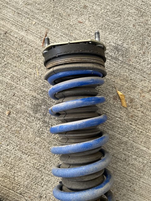

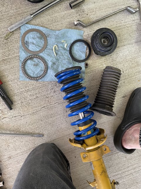

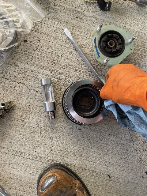

Just a little progress report. Roughly 3000 miles later and the spacer bearing+rubber ring is still holding up nicely. The spring setup is still working great. The front is great with the B6 struts, but since I’ve still got 60k mile stock rear shocks, there’s a wee bit of bounciness back there. Rear B6’s are still on backorder, but I’ve been keeping an eye out for used ones. I think I might be sad when I swap out this setup for the bigger and better custom suspension I’m working on 😢
One thing I realized after talking to someone with a Swift setup - the 3.0” ID spring I’m using is smaller in diameter than the stock style lowering springs, so there’s more clearance if you try to use camber plates up top (Compbrake/DNA), as normally the spring can contact the tower if you shift it in too far.
I'm genuinely curious how this actually stacks up to a the Swift Spec-R in terms of ride quality and handling. Sadly I haven't had a chance to ride in a car so equipped (only the stock and Mountune).

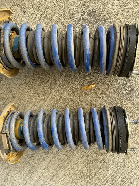

It’s time to give these springs a final report card, and I think they deserve an A+
The car has been handling and surprisingly,
riding slightly better than stock on the stiffer springs - probably because they don’t bottom on the bumpstops nearly as often
I’ve run them on the car for a year and a half, and a bit over 11,000 miles, and they’ve held up well. The rubber gasket rings I added as spacers still look almost new even though I was worried about them.
Then springs didn’t really settle that much, but if anything they look even closer to stock than before. Aside from being a bit dusty from driving on dry dirt roads, they held up really well
I’m finally moving onto my fancier customized Bilstein suspension now that it’s finally ready, so these are being retired. Not sure whether I’ll keep them as spares or just find a new home for them.

Since some other people have expressed interest in trying this, I though I’d add a couple of tips on assembly of the front:
For the Front:
1) It was easier to insert the stock rubber accordion inside the spring before trying to put the spring on the strut perch.
2) Set the bottom of the spring into the rubber slot on the strut perch
3) Then, insert the bumpstop into the top of the boot and onto the shock shaft, pointy end down towards the strut. Don’t worry about stuffing it all the way down, it will settle into the right position once everything is together
4) Stack the added roller thrust bearing on top of the rubber boot, followed by the cam lock gasket and the OEM plastic bearing. You can also set the three together (cam lock gasket in between), then drop them onto the shock shaft
5) Drop the hat (OEM or aftermarket) onto the shaft and seat it into the bearing
6) You should then be able to stand the strut up, shove down on the shock hat with your hand and insert the hat onto the shock shaft just enough to get the topnut started. No spring compressor required!
7) Tighten and torque the nut to the shaft and the strut is then ready to install!
I used one of these handy dandy strut nut sockets that makes things easier to install by fitting an Allen key in the open side.
https://www.pelicanparts.com/More_Info/PEL003046SCH01A01.htm?pn=PEL-003046SCH01A-01
For the Rear:
1) The helper spring goes on the bottom towards the torsion beam - this helps the main spring stay more vertical aligned with the car body instead of bending around
2) add 2-3 Zip ties between the main and helper spring around the spring adapter. Not necessary once installed, but it makes it way easier to install the spring without having to hold 3 things in place
3) Optional, if you have poly top mounts, you can trim the little anti rotation flange tab for the OEM spring to let the coilover spring sit more centered on the perch. Obviously this means it won’t be there if you try to reinstall the OEM spring
4) Jack the car up on jackstands and put the jack under the torsion beam. Loosen the lower shock bolts and lower the beam using the jack which makes install a piece of cake.
5) Swapping the rear springs (or shocks) does not affect alignment (which is entirely controlled by the torsion beam and bushings on this car), so you can do the rear anytime without needing to get the car realigned. There’s no rear adjustment anyway!
